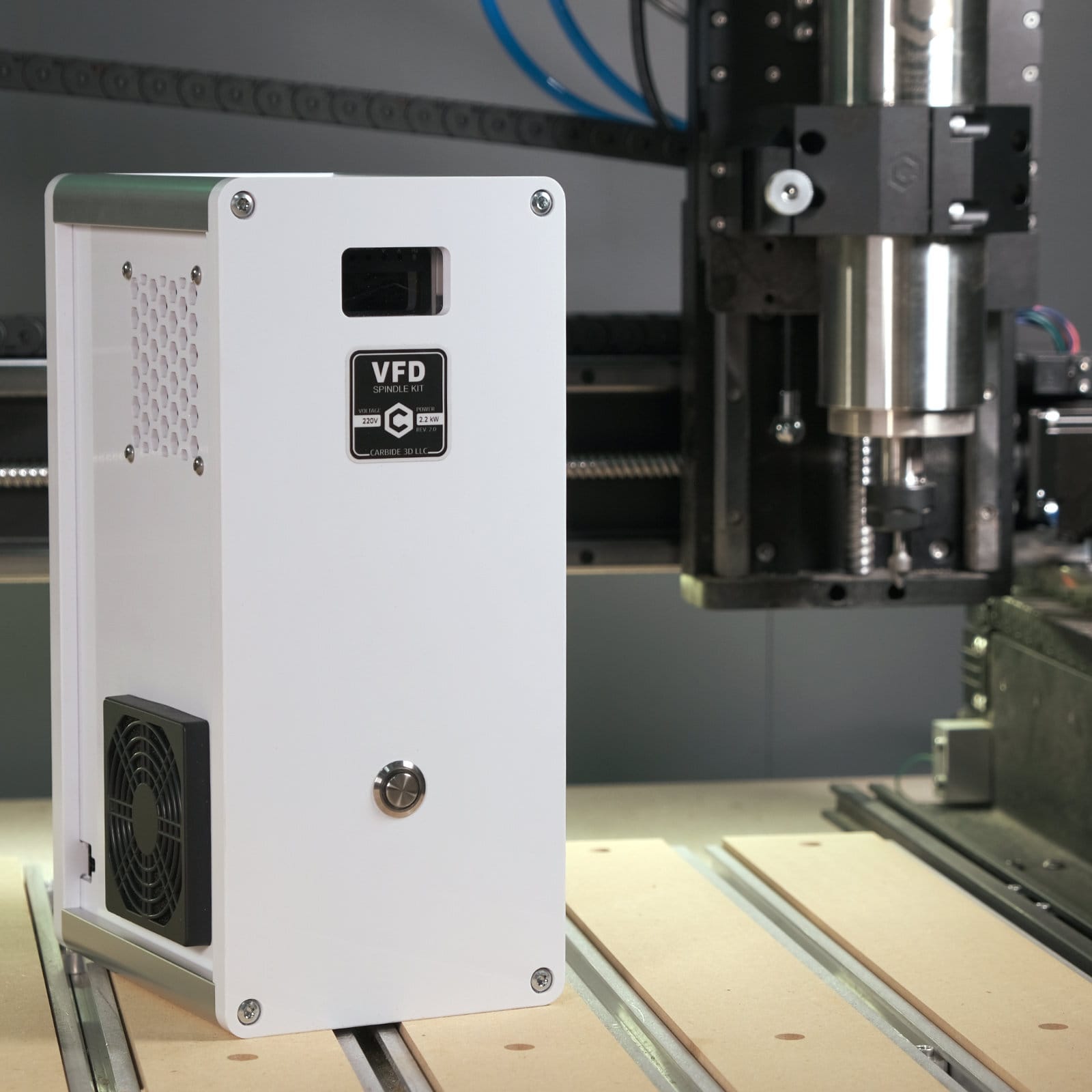

About the VFD Spindle Kit
The VFD Spindle Kit control unit includes custom electronics to suppress electrical interference and a make the system plug-and-play with all Shapeokos. Spindle activation and RPM is controlled by your G-code or cutting program.
This spindle uses ER collets, which allow the spindle to hold endmills of various diameters. For a detailed explanation about how ER collets work, please read our primer here.
A six-month warranty is provided on the spindle and VFD control unit.

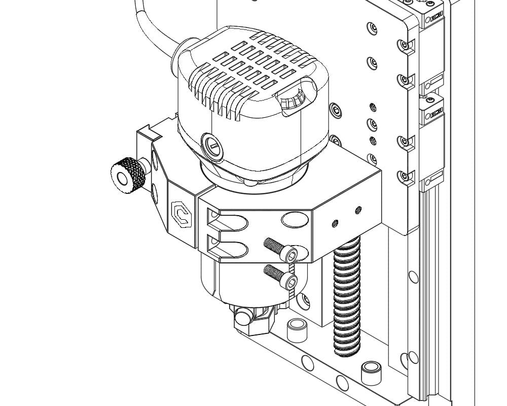

  • Using a 5mm hex key, loosen the two M6x20 bolts on the spindle mount's right side.
  • Remove the old router or spindle by lifting it up through the top of the spindle mount.

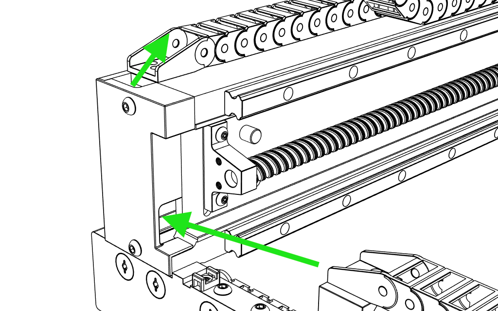

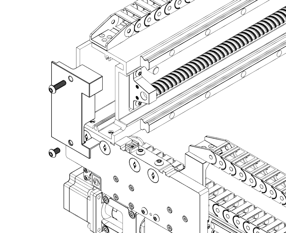

  • Remove the Left Gantry End Cap by loosening and removing two M6 socket head screws. (Shapeoko 5 Pro Only)
Depiction of removal of the Left Gantry End Cap on the Shapeoko 5 Pro.

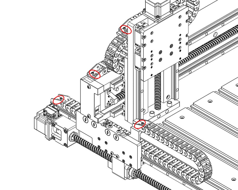

  • Remove the drag chains that guide the spindle power cable. These are the left side Y-axis drag chain and rearmost X-axis drag chains on the machine.
    • Using a 2.5mm hex key, remove the eight M3x6 socket head screws that secure the left-side Y-axis and rear-most X-axis drag chain. The bolts are located on the left Y carrier plate, left Y rail/limit switch mount, left X extrusion, and rear X/Z drag chain bracket.
Location of drag chain mounting screws on a Shapeoko 5 Pro.

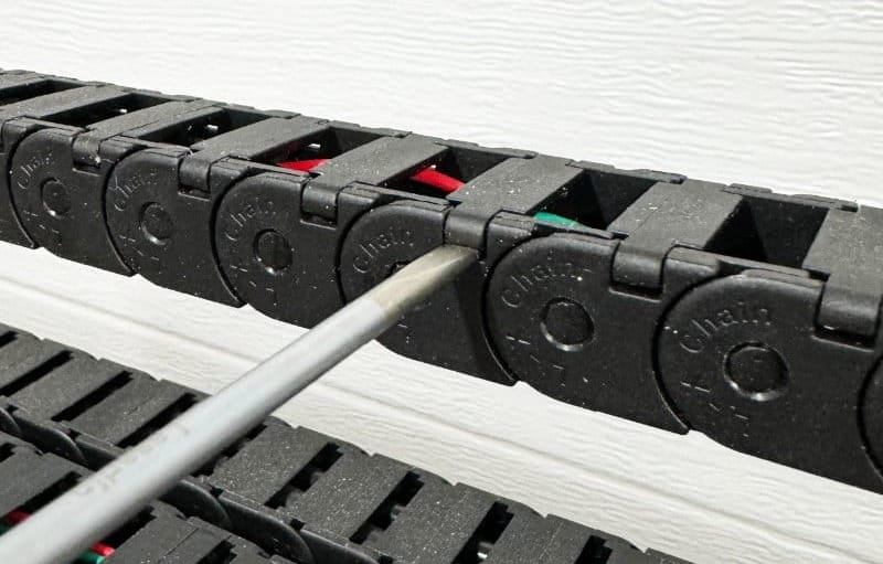

  • Open all drag chain links using a flathead screwdriver.
    • Insert the screwdriver tip underneath one end of the link cover, approximately 1/16" or 1.5mm deep, and twist gently to pop the cover open.

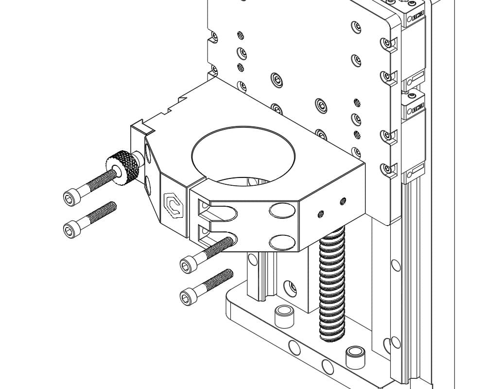

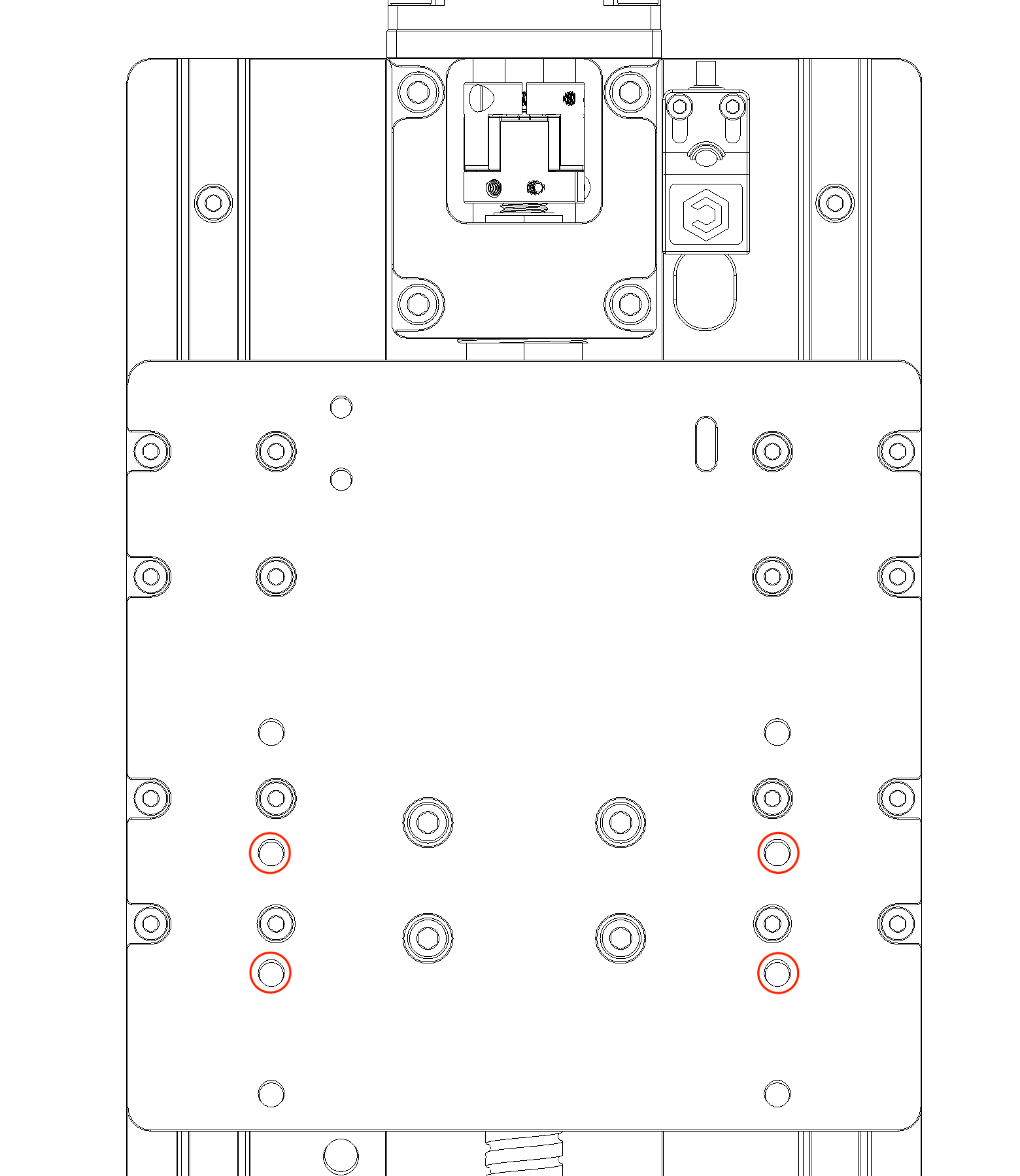

Step 2 - Raise Spindle Mount (5 Pro Only)
  • Using a 5mm hex key, remove the four M6x35 bolts securing the spindle mount to the Z-axis.
    • Note: The Z-Plus on the Shapeoko 3/4/Pro does not have an alternate installation position for the spindle mount. Skip this step.
  • Raise the mount to utilize the middle set of M6 mounting holes. Using a 5mm hex key, remove the four M6x35 bolts securing the spindle mount to the Z-axis.
Middle Mounting Holes
Use the middle set of 4 M6 holes (circled red) for attaching the spindle mount.

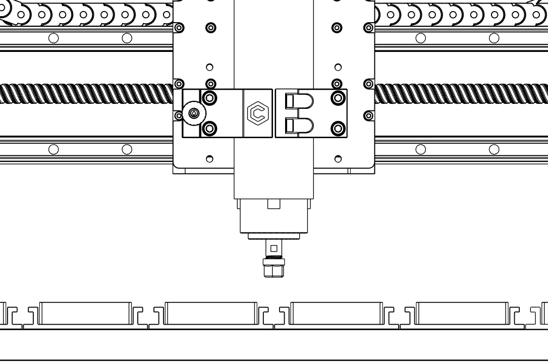

  • Lower the ER16 Spindle through the top of the spindle mount and re-tighten the two M6x20 bolts that clamp the spindle mount shut.
    • Make sure you support the spindle from below so it doesn't fall through the mount and hit the table.
  • The VFD spindle should be installed at a height such that the shortest endmill in your arsenal is able to reach your work surface.
    • For most people, the nose of the spindle should be between 4 to 5 inches below the bottom of the mount.
An illustration of the VFD spindle mounted low enough that the collet nut is nearly able to reach the table with the Z-axis at the bottom of its travel.

  • The VFD unit should be placed in a location sheltered from dust and debris.
  • The VFD unit should be easily accessible. You must be able to operate the spindle lockout button on the enclosure.
  • The area around the VFD enclosure must be kept clear of anything that could hamper ventilation, specifically on the vented sides of the enclosure (left). We recommend maintaining a 30 cm (about 1 foot) separation between the VFD and any obstructions.

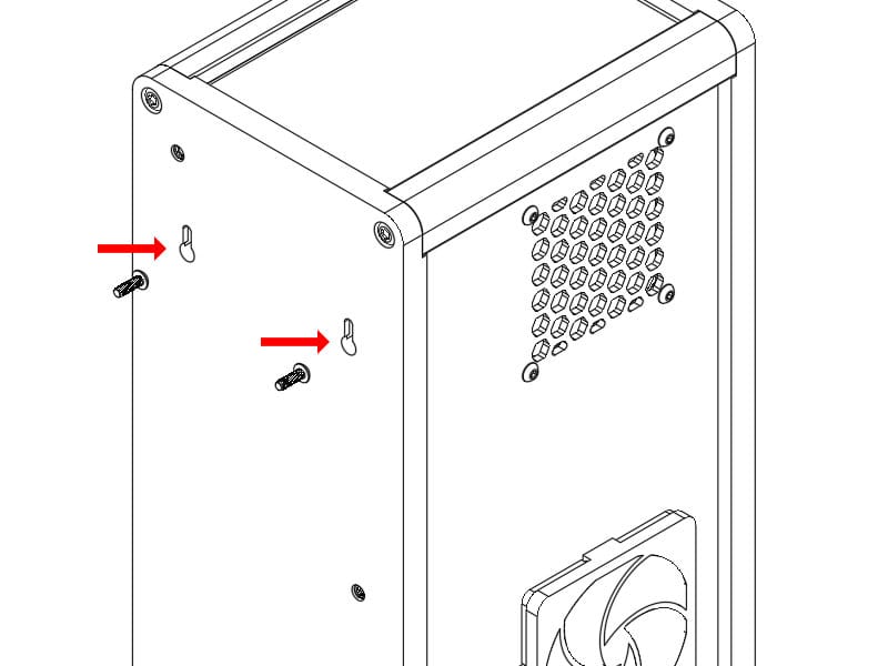

  • The VFD enclosure can optionally be wall-mounted. There are two slotted holes spaced 85mm apart that can be used to hang the unit.
Holes for wall mounting are located on the back of the VFD enclosure, spaced 85mm apart.

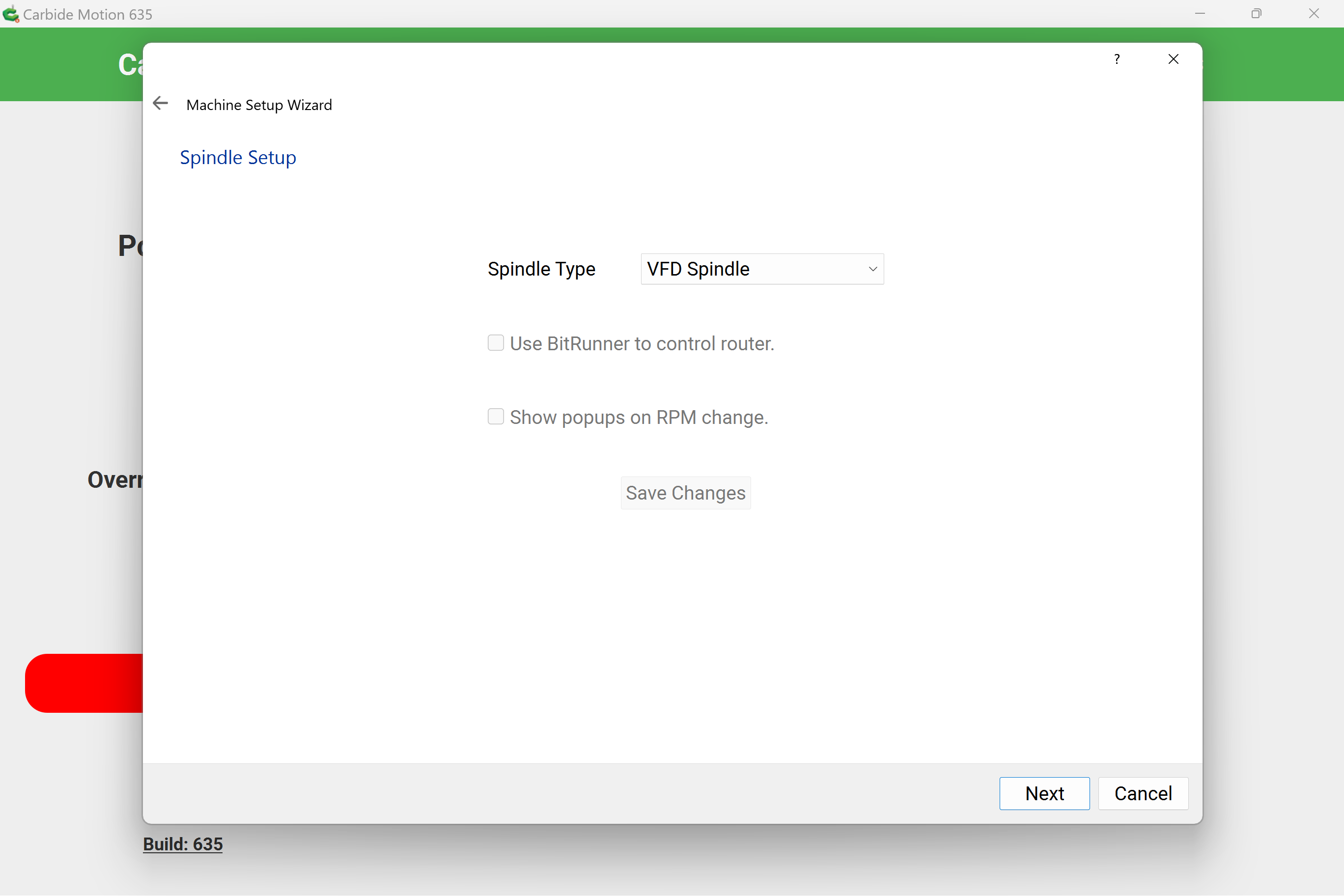

Step 8 - Configuring Carbide Motion
  • For your Shapeoko to communicate with the VFD correctly, you will need to run the New Machine Setup Wizard.
  • When prompted for the type of spindle being used on your CNC, select VFD Spindle

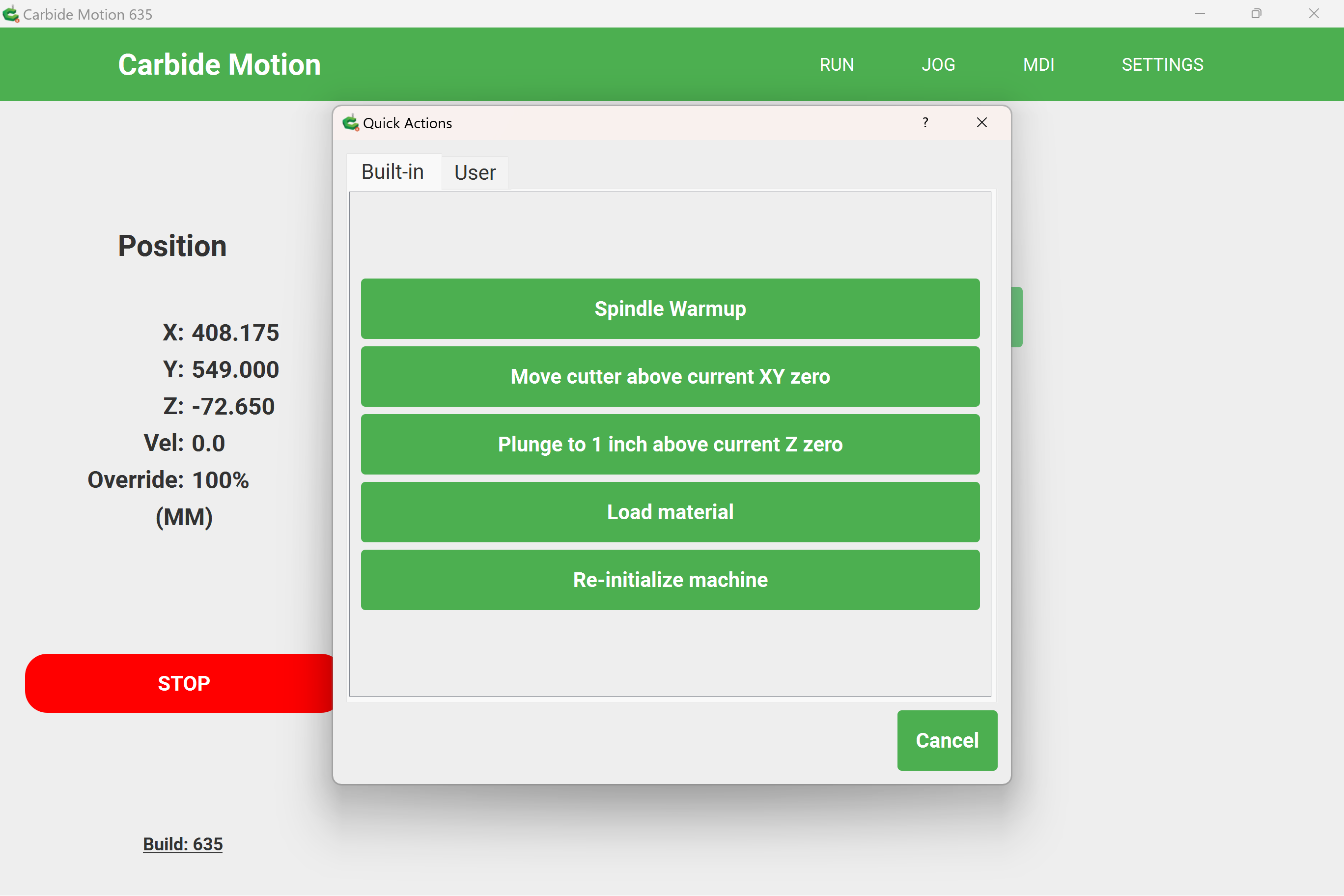

Before performing any cuts with the VFD Spindle, you should test and run a warm-up cycle. This is also recommended if the machine has been sitting idle for more than 2 days and/or if the ambient temperature is below 15°C/59°F.
  • You can run a built-in warm-up cycle through Carbide Motion's Quick Actions menu.

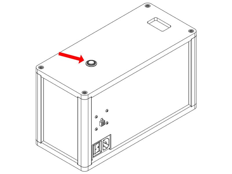

  • The Spindle Enable button on the front of the VFD controller disables the spindle. This can provide an additional layer of safety when you are interacting with the spindle (ex. changing and endmill), or be used to ensure the spindle does not run when using tools like drag engraving tools or drag knives.
    • If the Spindle Enable button is on (illuminated), the VFD is ready to run. If it is off, the spindle will not activate, even if commanded to in a program.
Location of the Spindle Enable (Interlock) button.

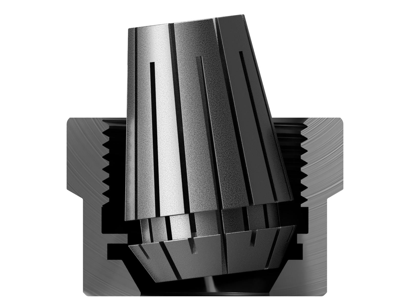

Proper Collet Usage
For a detailed explanation about how ER collets work, please read our primer here. The short version is as follows:
  1. A collet needs to be installed in the collet nut before a tool is inserted. The collet should loosely snap into a retaining groove in the collet nut.
  2. Likewise, you must remove an endmill from the collet before the collet can be separated from the collet nut.
  3. At a minimum an endmill should be inserted to the same depth as the back of the collet. An endmill should also not bottom out against the inside of the spindle shaft, otherwise it may not self-center properly when the collet is tightened.
  4. You may see a drilled divot(s) on the side of the collet, that is normal. It is for balancing.
  5. There is an off-center ring on the inside of the collet nut, that is by design. It is meant to capture the collet, and pull it out of the spindle when you loosen the collet nut.
  6. Periodically clean the collet, collet nut, and inside of the spindle shaft to remove dust build-up.
Cross section of an ER collet nut, showing the installation of a collet at an angle.
