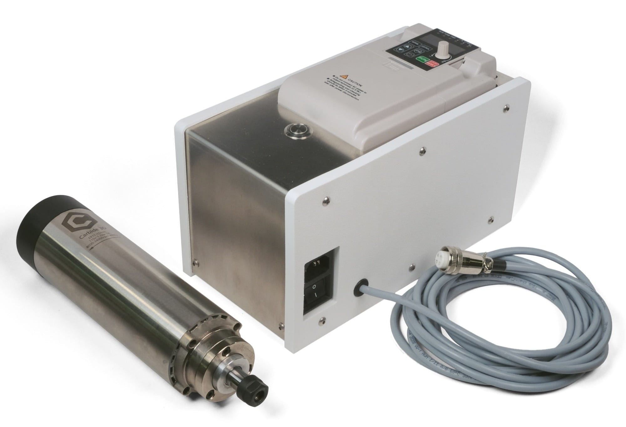

65mm VFD Spindle (ER-11)
VFD Spindle Kit
65mm Air-Cooled VFD kit
