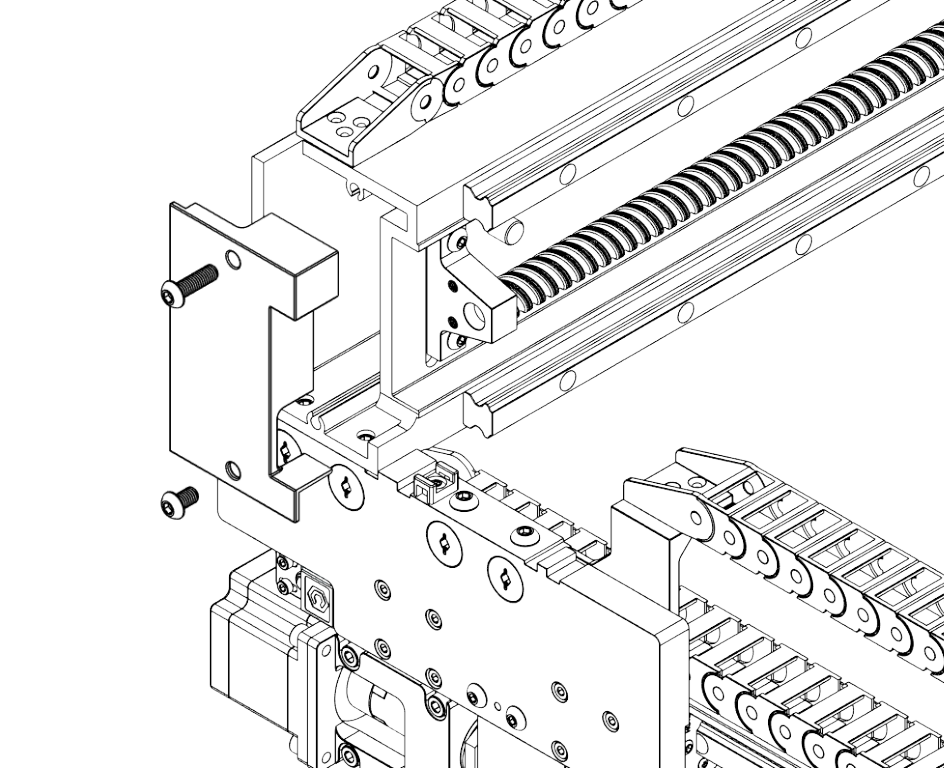

  • Remove the Left Gantry End Cap by loosening and removing two M6 socket head screws. (Shapeoko 5 Pro Only)
Depiction of removal of the Left Gantry End Cap on the Shapeoko 5 Pro.

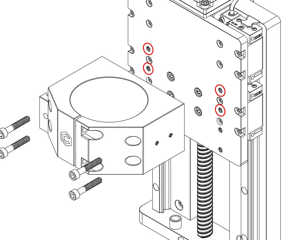

  • Align spindle mount with Z-axis front plate. The 80mm mount sits higher than the 65mm mount, allowing for greater tool clearance and adjustability for the dust shoe. The mount should be aligned with the top four M6 holes, near the center of the Z-axis front plate.
  • Secure the spindle mount using a 5mm hex key using four M6x35 bolts.
    • Do not exceed 10N·m of torque.
  • The dovetail feature should be on the left side.

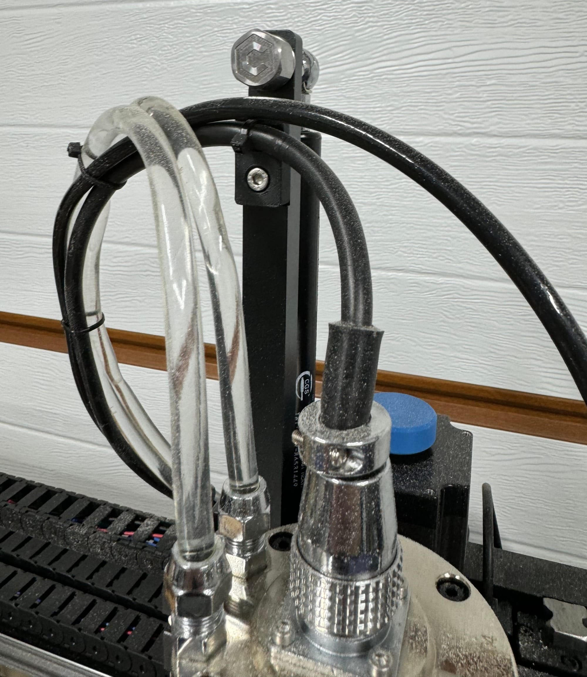

Install - Wiring & Coolant Lines (Gantry Drag Chain)

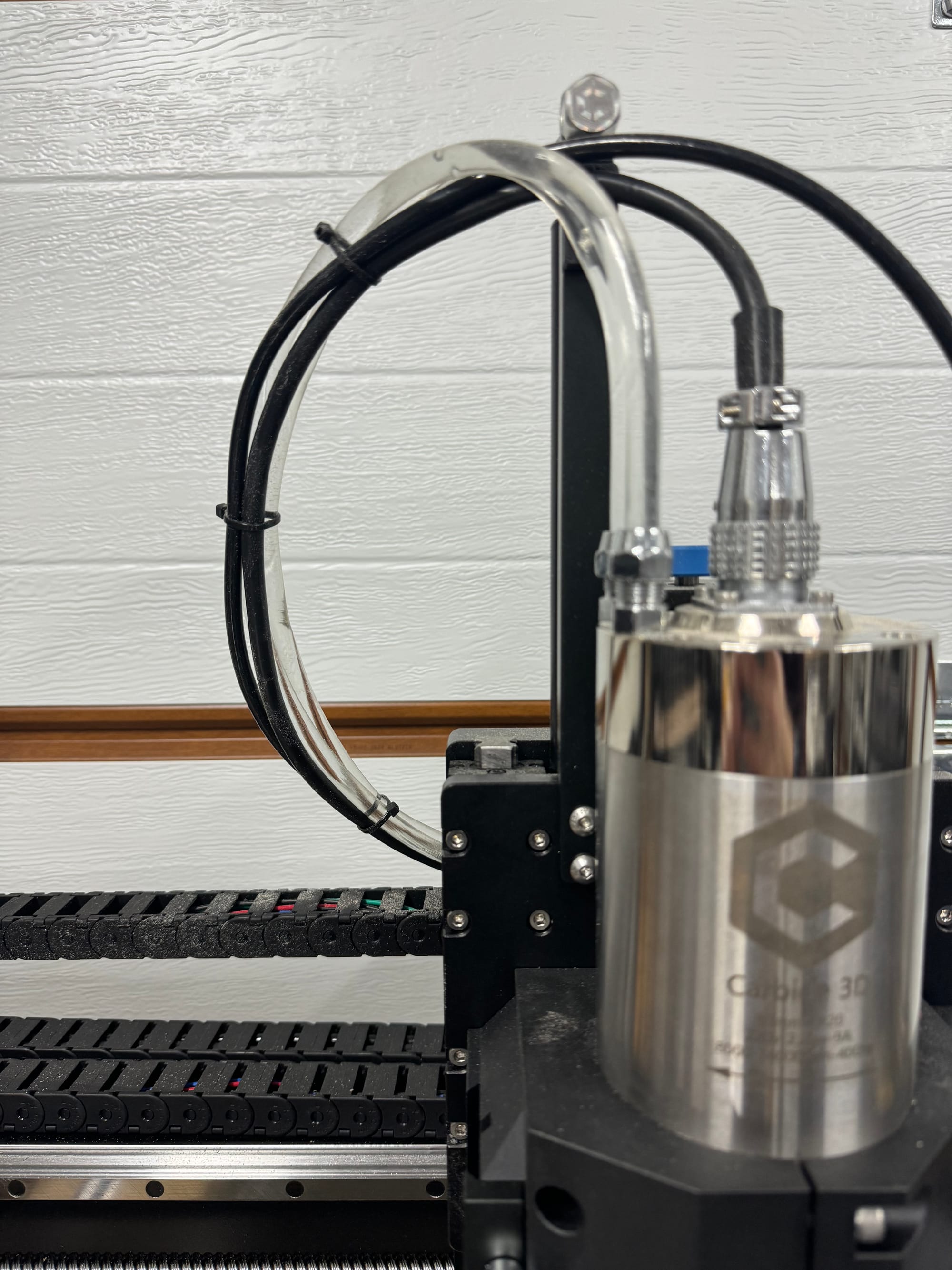

  • With the drag chain removed and links open, lay the spindle cable and water coolant lines in the drag chain.
    • Ensure the threaded spindle connector is on the side of the drag chain that terminates at the Z-axis.
  • Leave 65cm of spindle cable and water coolant line free on the Z-axis side of the drag chains.
  • Snap the drag chain links closed.
  • Using a 2.5mm hex key and four of the M3x6 bolts (previously removed) secure the X rear drag chain to the left X axis mounting point and rear Z/X drag chain mount.
  • Check for any kinks or sharp bends that could restrict water flow.
  • Plug the aviation-style connector into the top of the spindle. Screw the collar clockwise to secure.

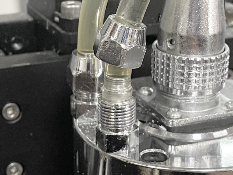

  • Remove the two compression nuts from the spindle's coolant ports.
  • Slide each compression nut onto a length of coolant line.
  • Press the coolant line onto the coolant fittings. If needed, the end of the coolant lines can be warmed in hot water to increase flexibility.
Image showing the arrangement of compression nut, coolant hose, and hose fitting prior to tightening of the compression nut.
  • Tighten the compression nuts with a small adjustable wrench until moderate resistance is felt. The compression nuts do not need to bottom out on the threads in order to create a seal, over-tightening may damage the hose.
  • Secure the spindle cable and the coolant lines as a single bundle using cable ties.
  • Secure the spindle cable to the Shapeoko 5 Pro Gas Strut Kit

  • Using a 5mm hex key, remove the black plastic end cap on the left side of the gantry by removing the top M6x30 and lower M6x12 bolt.
  • Carefully run the spindle cable inside the left gantry end cap.
  • Replace the end cap and bolts.

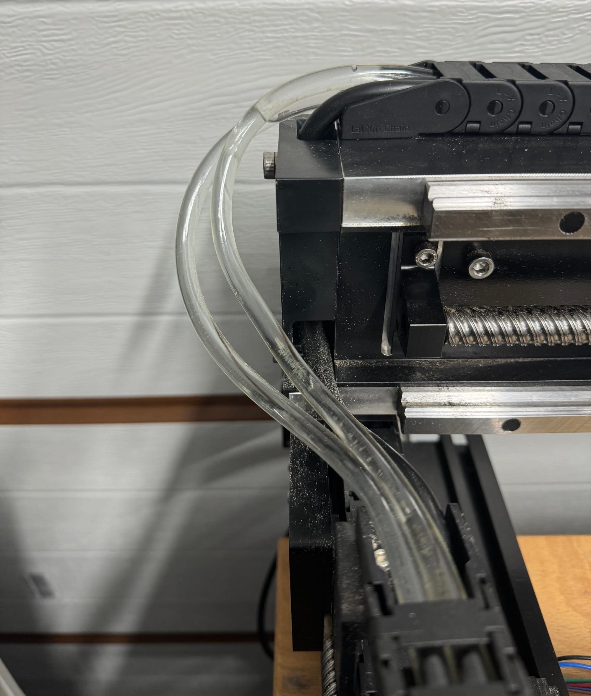

  • Water coolant lines should run outside the gantry end cap and transition to the left side drag chain.
    • DO NOT feed the coolant lines through the gantry end cap as this could hide a pinched or kinked hose.

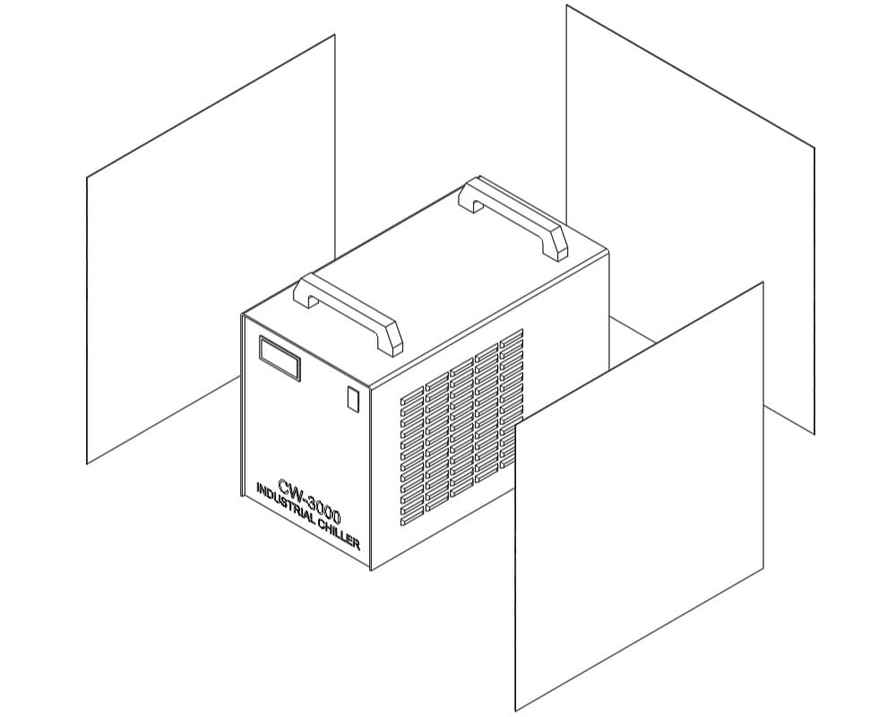

It should be placed away from dust and debris (ex. under or beside the Shapeoko). Approximately 30cm (1 foot) of clearance should be maintained around the unit for best performance.
Keep area around spindle chiller clear for ventilation.
