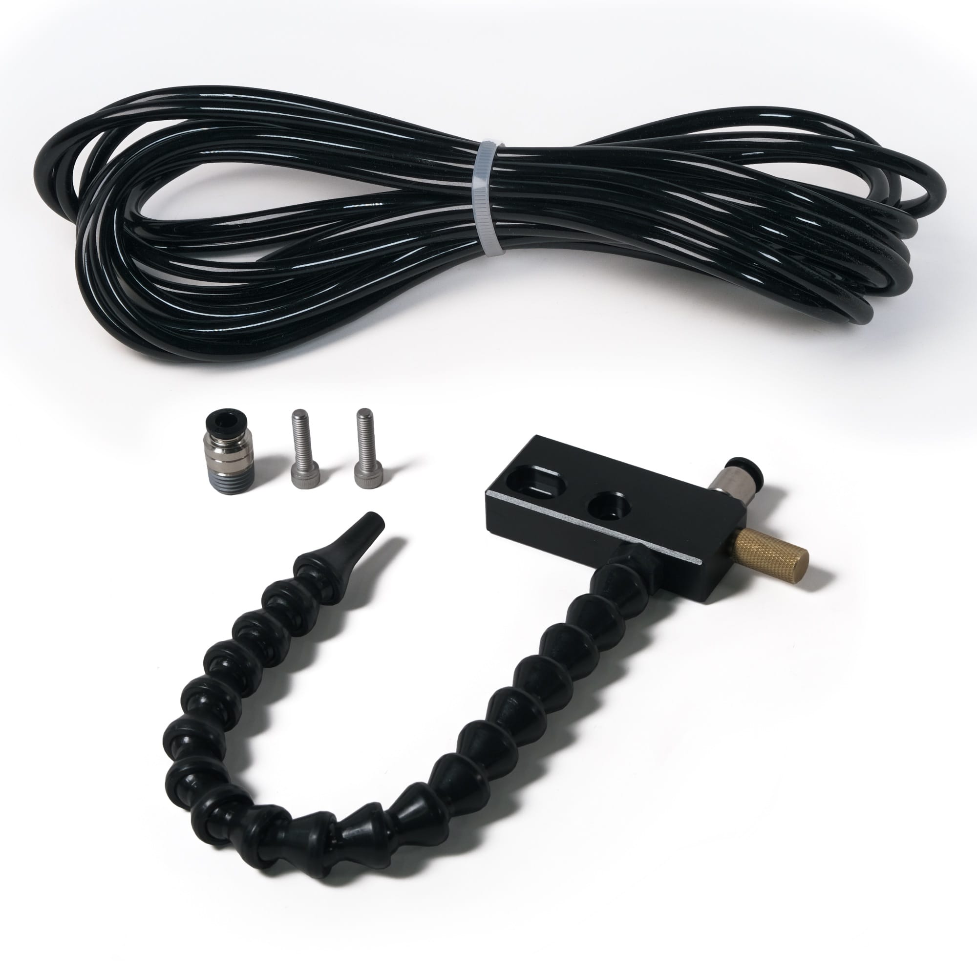

Contents
  • Air Assist Unit
  • 30 cm of Modular Hose with Nozzle
  • 6mm Polyurethane Tubing (6m length)
  • 6mm - 1/4 NPT Fitting
  • 2 x M5x20 Socket Head Cap Screws
  • Mating Plate
Air Assist Kit laid out with accessories. (Note: Mating Plate is not shown.)

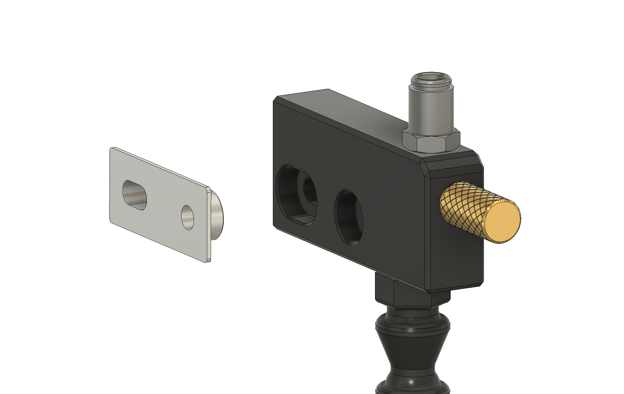

Step 3 - Mount the Air Assist Unit
  • Insert the mating plate on the side of the Air Assist Unit to be placed against the spindle mount.
  • This guide assumes the Air Assist Unit will be installed on the right side of the spindle mount.
  • Affix the Air Assist Unit to the side of the spindle mount.
  • Two M5x20 screws go through the body of the Air Assist Unit and secure into the spindle mount.
  • Push the air supply tubing into the 6mm fitting on the Air Assist Unit.
  • Use cable ties to secure the tubing to the spindle power cable to clean up the installation.
  • Ensure there is adequate slack to prevent the spindle power cable and airline from being snagged or strained as the Z-axis moves up and down.
