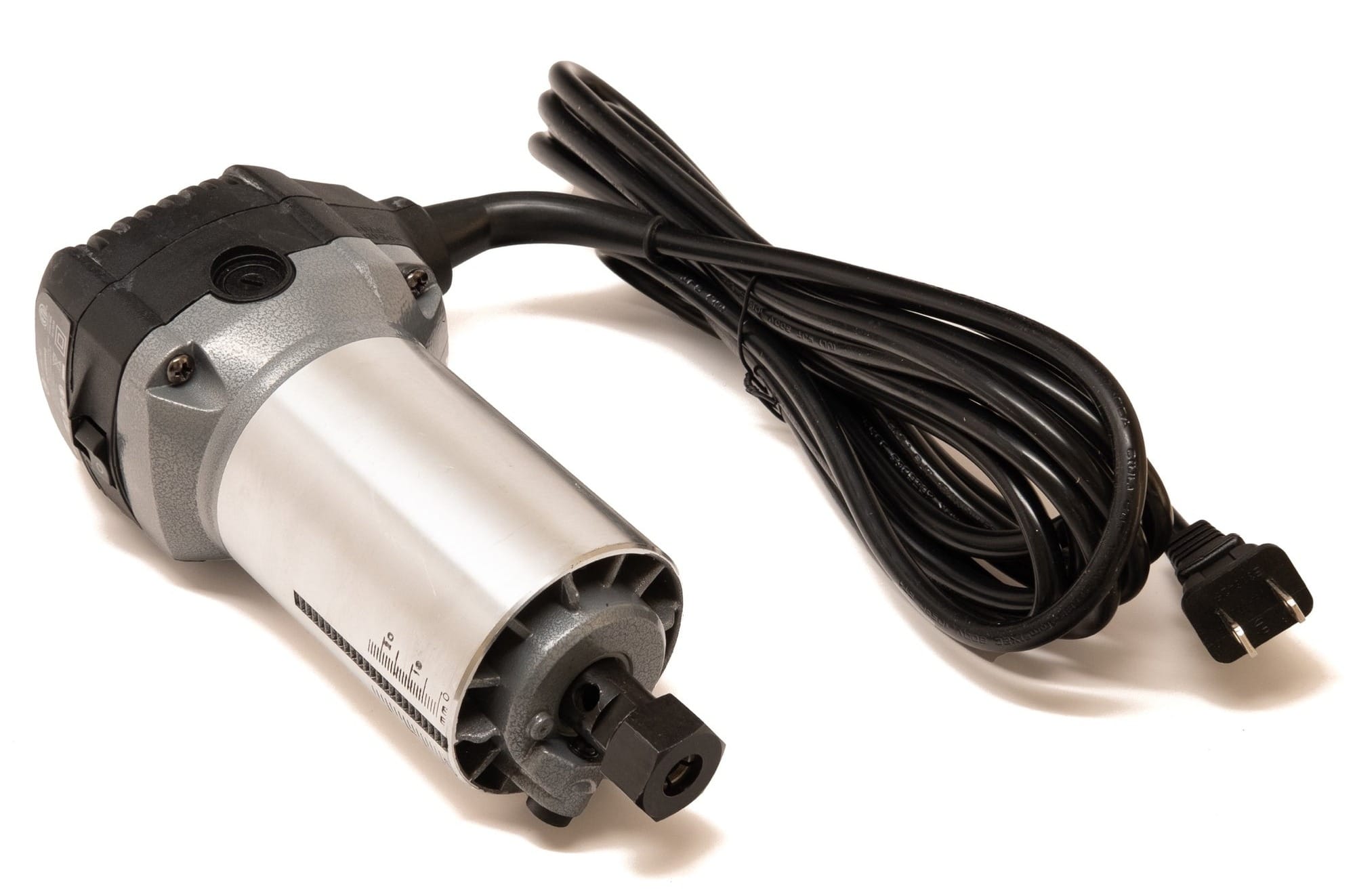

The Carbide Compact Router is available in two different models:
- The standard Carbide Compact Router that uses proprietary collets.
- The ER-11 model that uses standard ER-11 collets to hold tools.
Internally, both routers are identical. There is no difference in performance between the two.

Clamping the Carbide Compact Router
The Carbide Compact Router features a 65mm diameter body meant to be clamped into our CNC Routers.
When clamping the router, it's essential to use only enough force to hold it in place rather than tightening it down as much as possible.
Overclamping the router will lead to premature failure.
The best general advice is what we said above: only clamp the router enough to hold it in place. If you happen to have a torque wrench, our testing has shown that 7Nm of torque on the two clamping screws should be sufficient.
