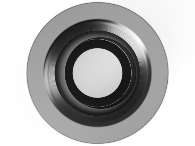

Looking inside an ER collet nut, note the ring that appears to be off-centered.
If you look inside an ER collet nut, you'll notice that one of the machined features appears to be off-center. This is not a manufacturing defect, but actually a lip that's meant to trap a collet and force it to stay with the collet nut as you tighten and loosen the nut.

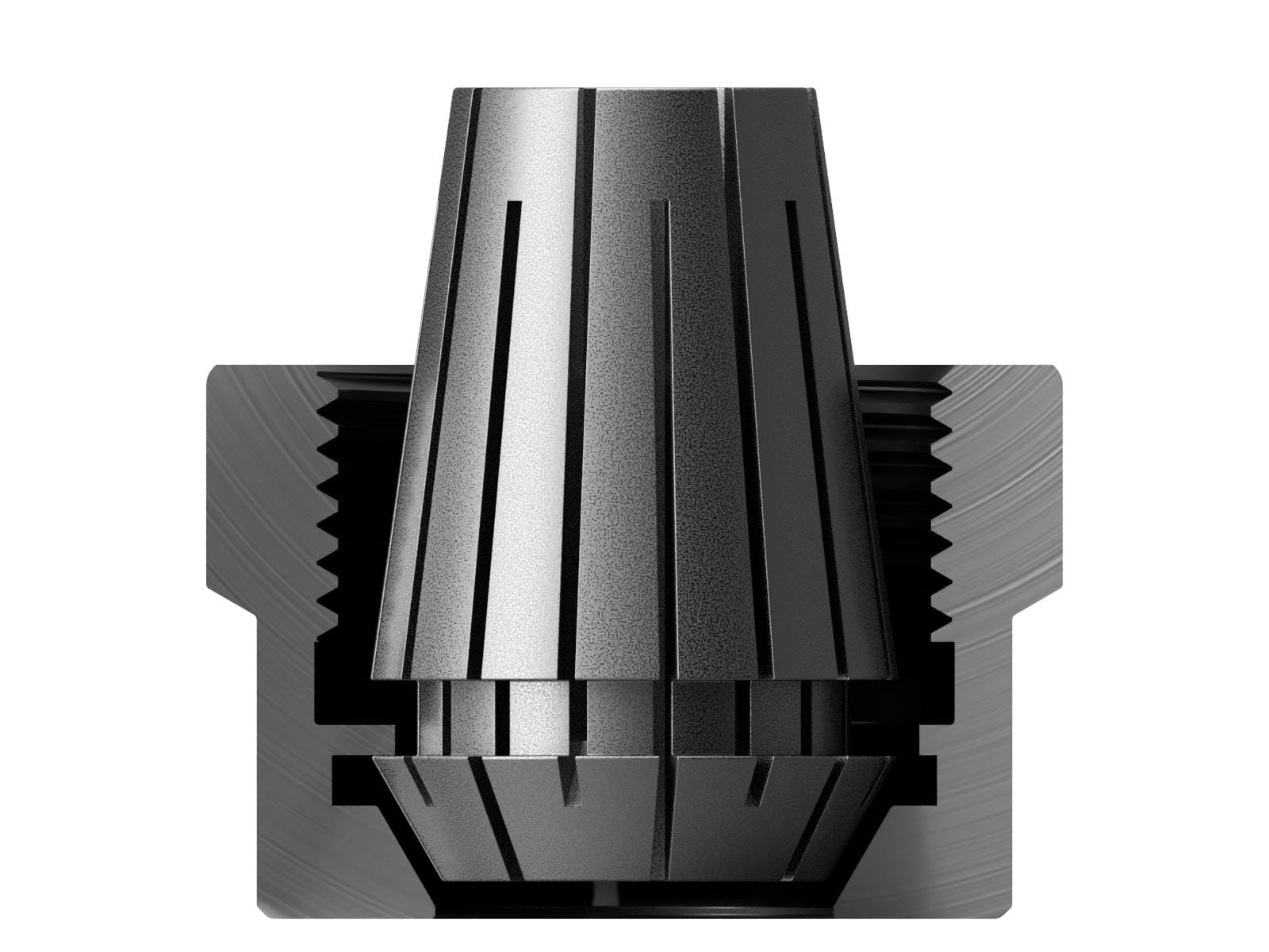

Cross section of an ER collet, with the retention ring engaged with an installed collet.
The retention ring falls into a matching groove on a collet, so that as you tighten and loosen the collet nut, the collet moves into and out of the spindle taper in unison. Without this feature, a collet might get wedged inside the spindle shaft and be difficult to remove.

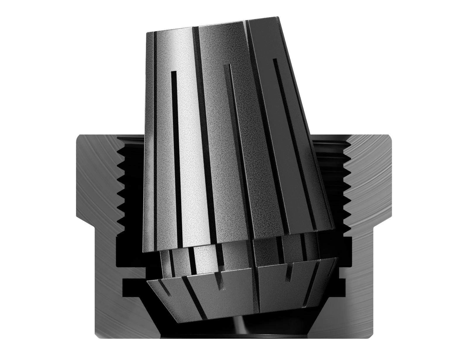

The proper way to install an ER collet into a collet nut is to insert the collet at an angle, and then rock it into an upright position. You may need to also apply some axial pressure on the collet and allow it to compress and fully snap into the retention ring.
To separate a collet and a collet nut, you would need to tilt collet in the appropriate direction in order to free the collet from the retention ring. You might also need to apply some pressure to the nose of the collet from below to pop it out of that ring.
Cross section of an ER collet nut, showing the installation of a collet at an angle.
Note: You cannot have a tool in the collet before you put the collet in a collet nut. If you already have an endmill in a collet, the collet will not be able to compress enough to snap into the retention ring. And if you try to run a spindle like this, the collet will be pushed off-center when you thread it onto a spindle, resulting in poor performance, reduced accuracy, and potential damage to your spindle and collet.

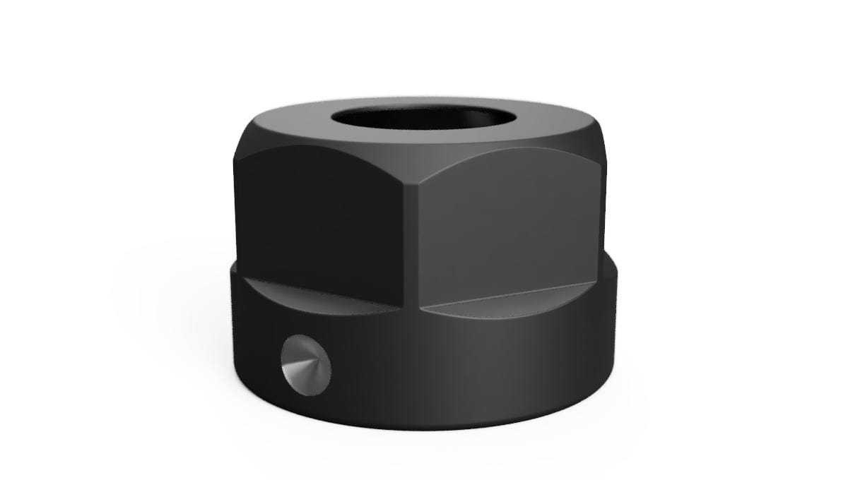

On some collet nuts, you may see small dimples or divots around the perimeter. Again, this is not a defect or blemish, but a deliberate feature meant to balance the collet and reduce vibrations. It is no different than how tires and wheels on an automobile are balanced, except in this case we cannot attach weights to a collet nut so instead we drill out mass.
An ER collet nut that has been drilled for balance.
