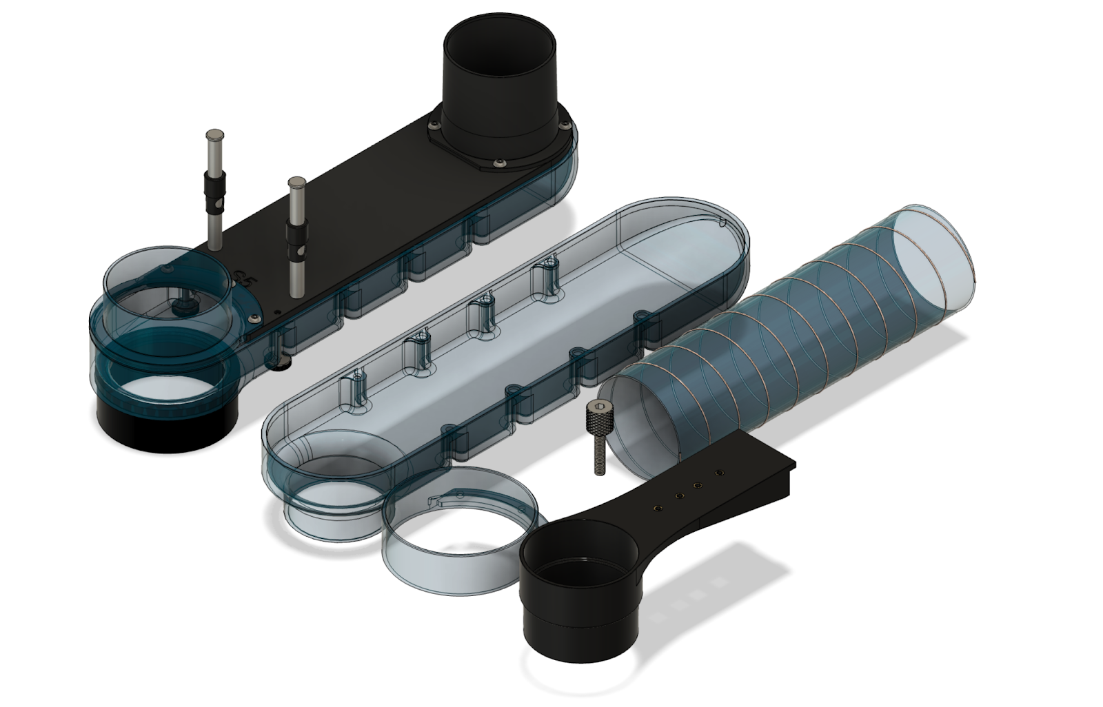

Kit Contents
Hose support:
  • X-axis hose support with dust port
  • Two M5x10mm socket head screws
Dust Boot Top
  • Dust boot top - machined plate with 6 magnets fitted (engraved S5)
  • 80mm injection molded clear vac ring
  • 65mm injection molded clear vac ring
  • Lower injection molded hose support
  • Seven M4x6mm screws
Slider Assembly
  • Two Slider support
  • Two 8mm dust boot supports
  • Dust boot height adjuster screw
  • Two M5 x 10mm screws button head
  • 2.5 Flexible hose (approx 230mm)
Dust boots & Accessories
  • Dust boot base with a brush
  • Dust boot base without brush
  • Dust boot thumb screws
  • 2.5" Hose adapter
  • 35/36mm adapter
  • Threadlock

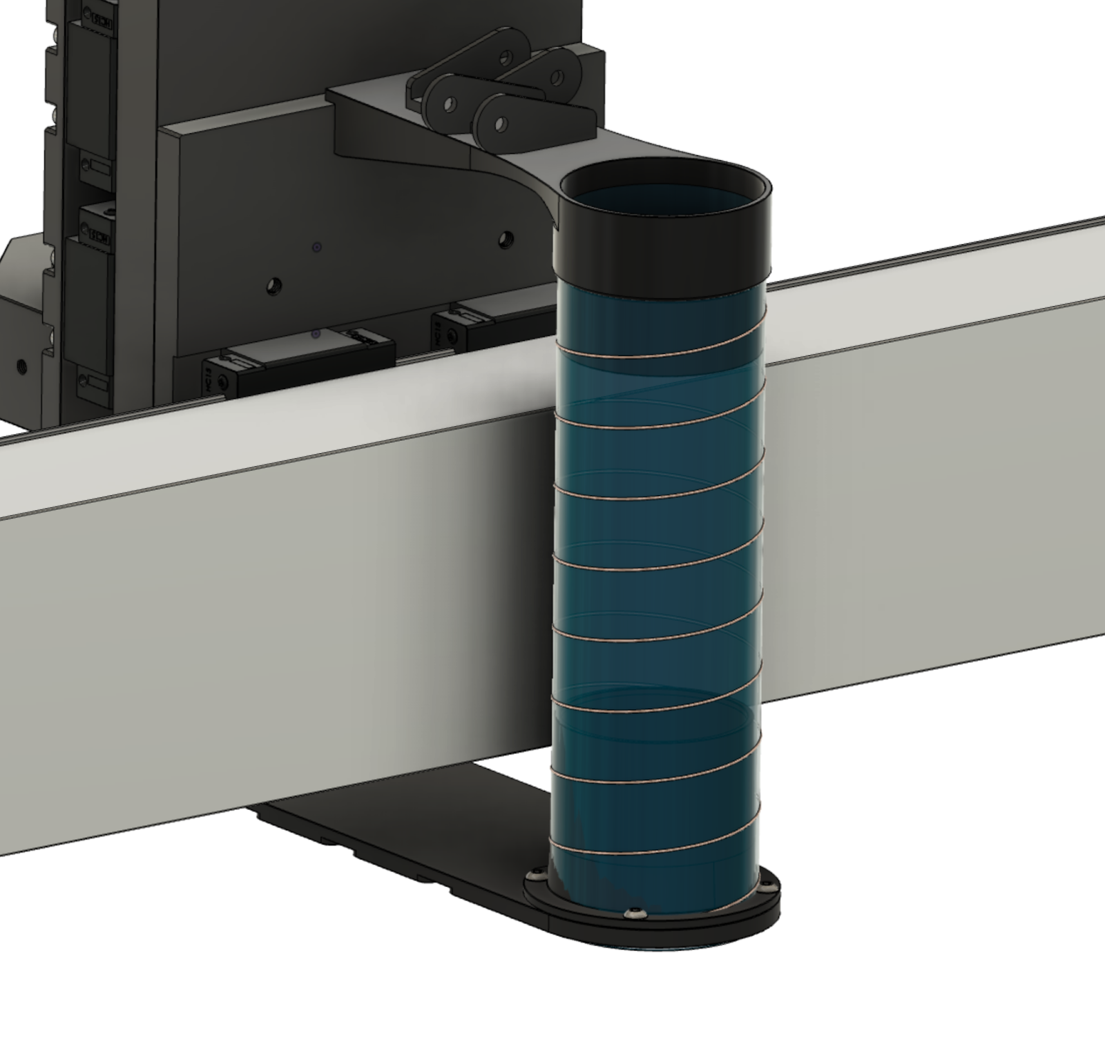

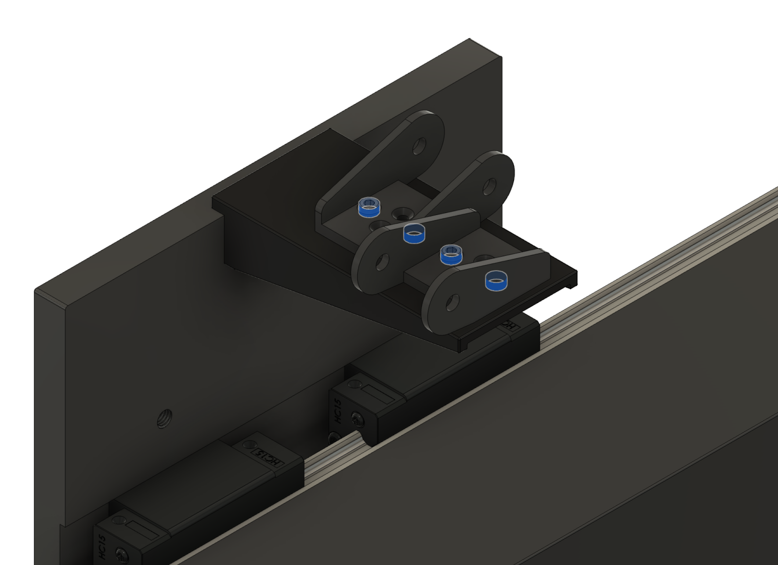

Fitting the X-axis hose support
  • Bring the X/Z axis to the center of travel - ensuring sufficient visibility and access.
    • It's recommended this is done from the rear of the machine.

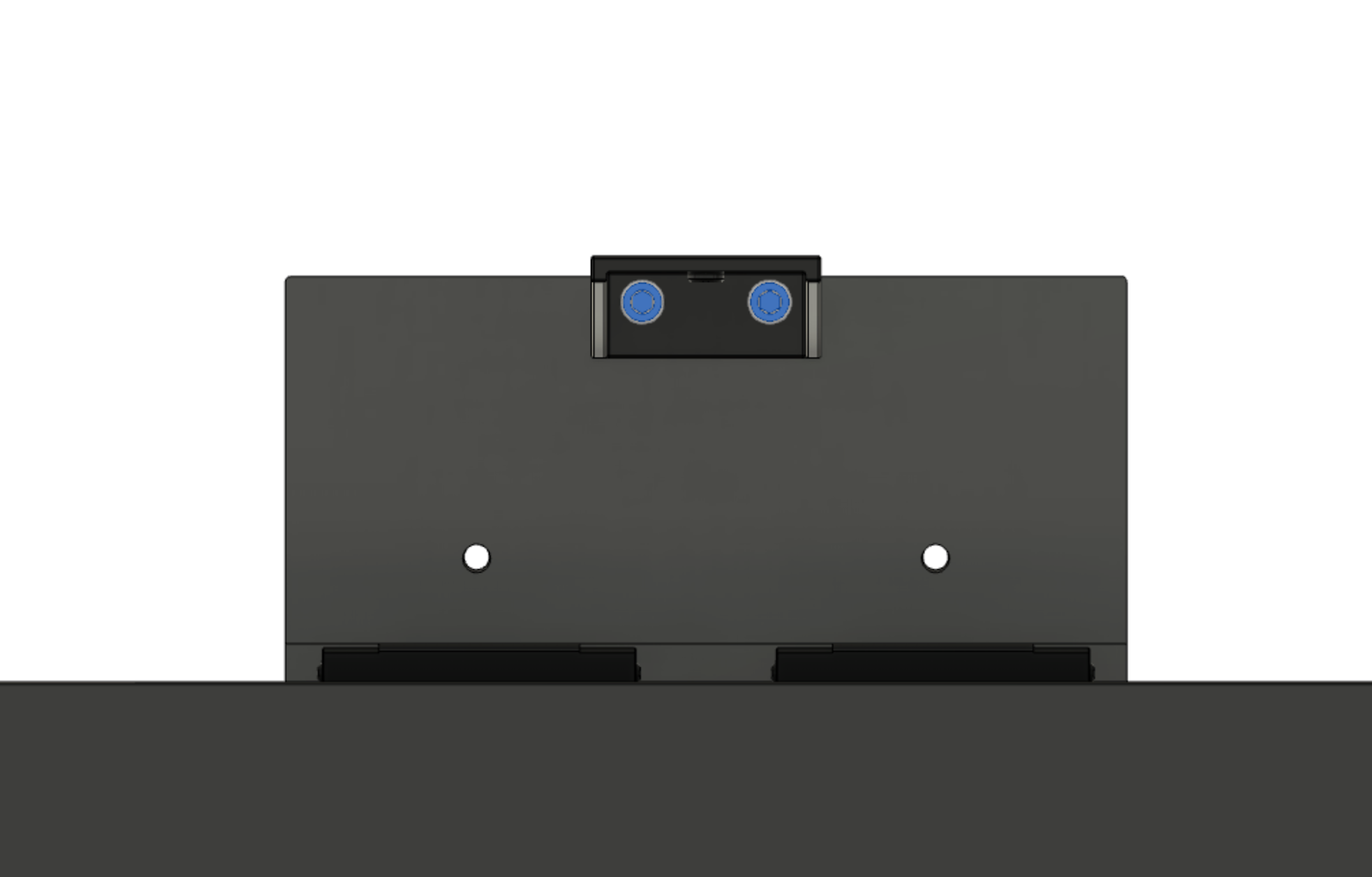

  • Remove the four M3 screws holding the drag chains in place.
  • Remove the two M5 Screws holding the rear drag chain support.

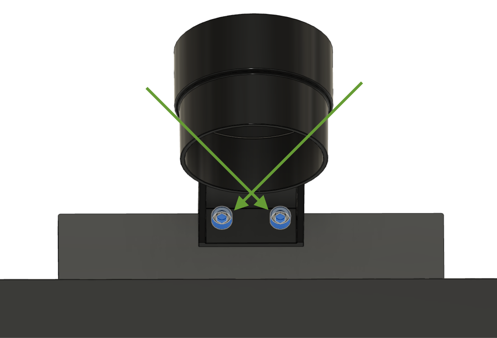

  • Remove the X drag chain support from the machine.
  • Fit the X hose support with two M5x10mm screws.
    • Note access is restricted - it’s best to approach with a 45 angle with the ball end of the Allen key.
  • Re-fit the X drag chains to the new support.

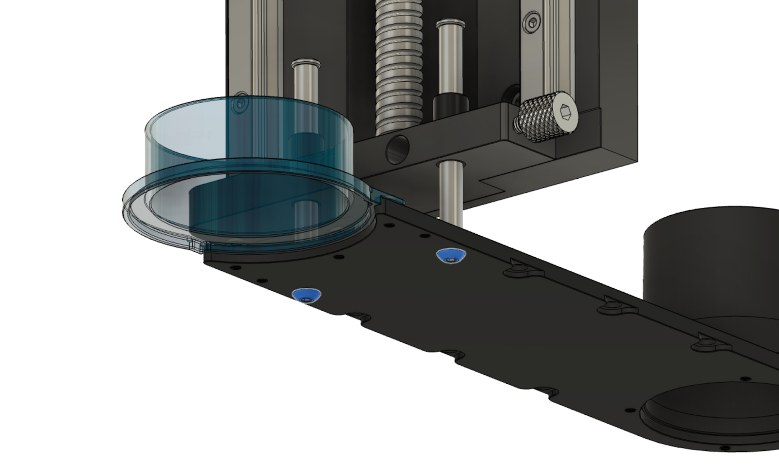

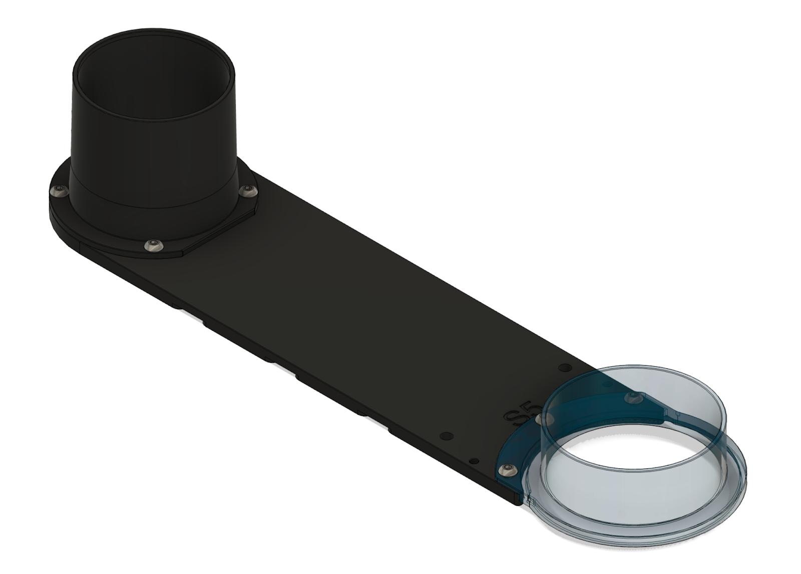

Dust boot top assembly
  • Fit the lower hose support and vac ring with the seven M4x6mm screws provided.
    • The lower hose support has a flat section. This should be facing toward the vac ring, as shown.
    • Select the appropriate vac ring for your spindle.

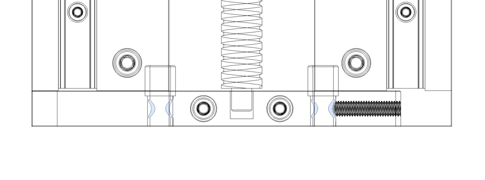

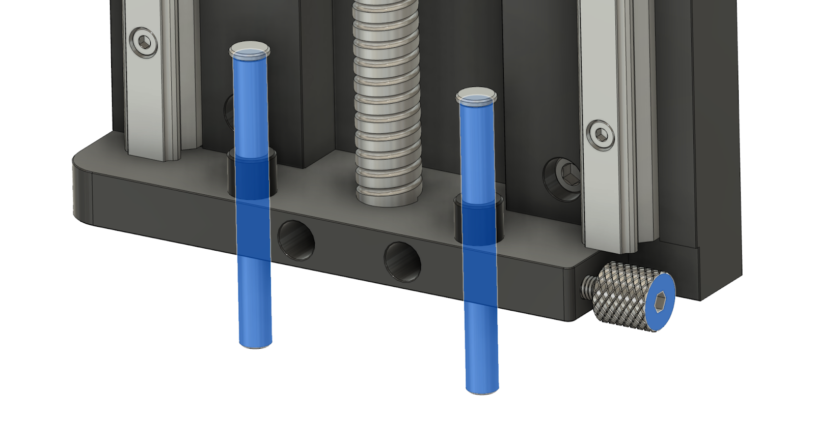

Slider Assembly
  • Apply a small amount of thread lock to the outer rear diameter of the slider supports.
  • Insert both slider supports in the lower ball screw support.
    • This can be done with the Z in the raised position.
  • The openings should be in line with the M6 Screw thread on the right side of the axis.

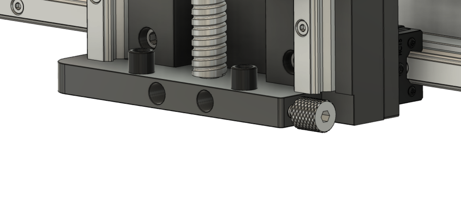

  • Insert the dust boot supports into the slider support from above
  • Insert the dust boot height adjuster screw and screw clockwise.
  • To raise or lower the dust boot, rotate the dust boot height adjuster screw clockwise to tighten and counterclockwise to loosen.
  • The right support should lock into position. The left will remain loose.
  • Insert the two M5x10mm button heads into dust boot supports.
    • Apply a small amount of thread lock to these screws and grip the supports at the flanged end and not the shafts.

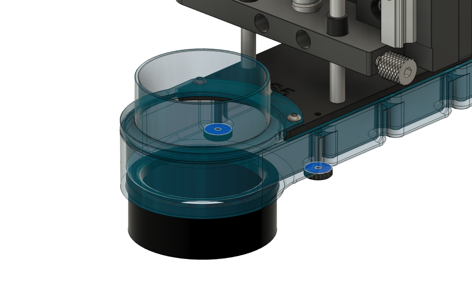

Fitting the dust boot
  • Either the clear or brushed version of the dust boot will be located on the dust boot base with magnets.
  • It is essential that you manually push the dust boot onto the dust boot plate to ensure it is clipped on correctly. Do not just rely on locating magnets.
  • Once in position, you should lock it in place with the two dust boot thumb screws.
  • These can be inserted from below and tightened with a 3mm hex key as required.
