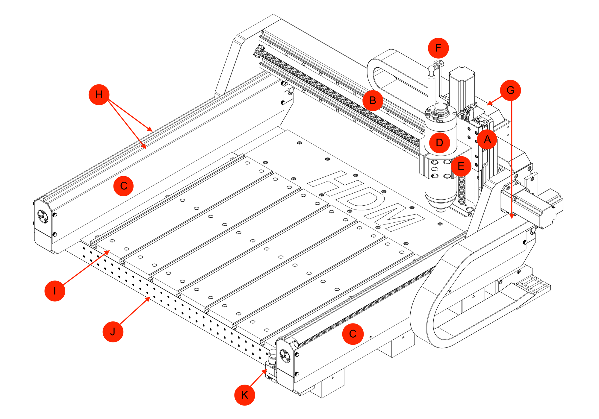

Assembly Diagram
The Shapeoko HDM 3.0
  • A - Z-axis
  • B - X-Axis
  • C - Y-Axis
  • Stepper Motors - at the end of each axis
  • D - Spindle
  • E - Spindle Mount
  • F - Gas Strut
  • G - Drag Chains X and Y
  • Linear Rails - located on each axis
  • Ballscrews - located centrally on each axis
  • H - Y Axis Covers - on both Y-axis
  • I - Hybrid Table x 7
  • J - Vertical Mounting (M6 holes)
  • K - BitSetter
Assembly Diagram
Assembly Diagram

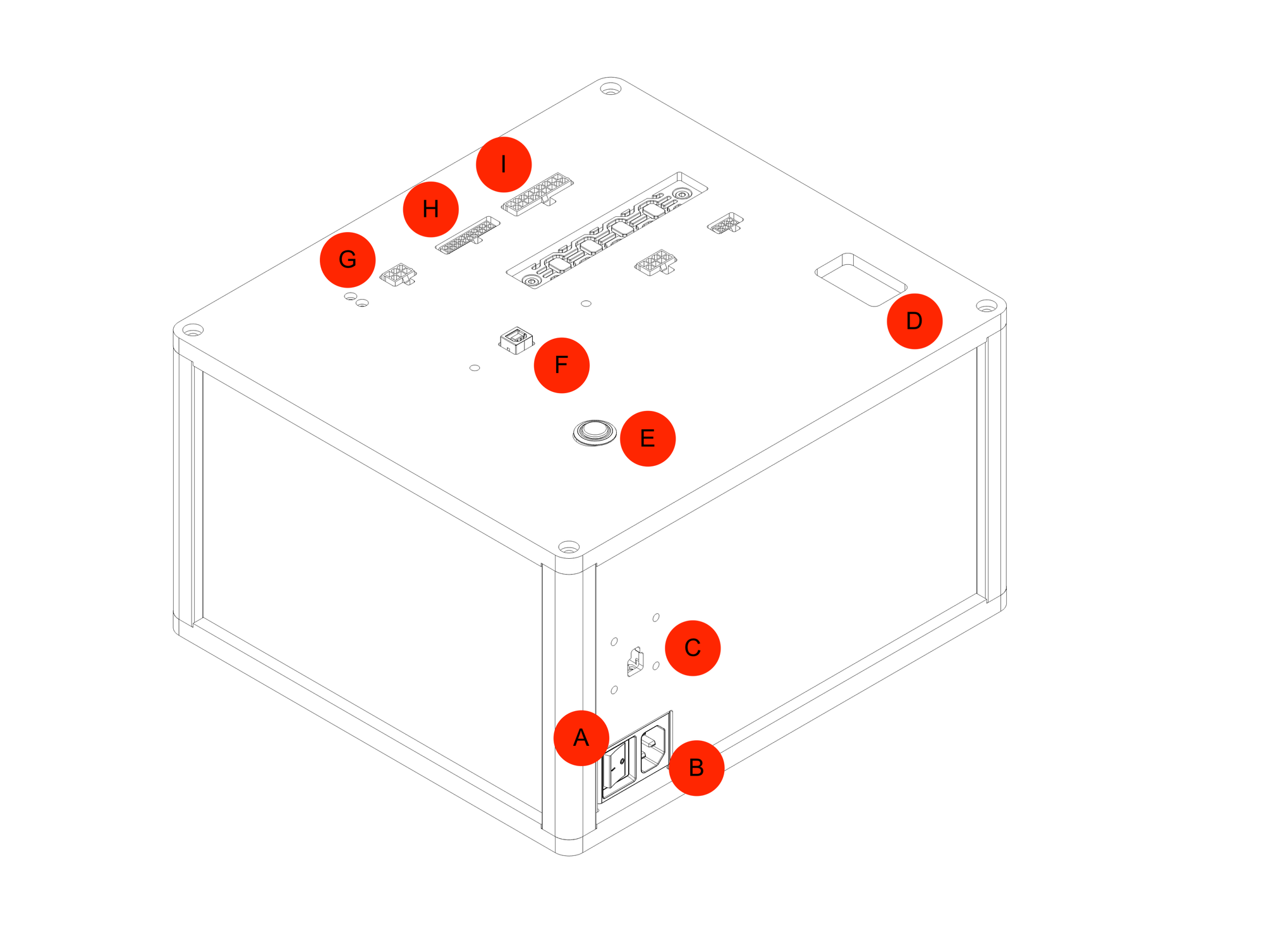

The Shapeoko HDM 3.0 Electronics Diagram
  • A - Power Switch
  • B - Power Input
  • C - Spindle Output
  • D - VFD Display
  • E - Spindle Lockout
  • F - USB Port
  • G - Power Pendant Port
  • I - HDM-W2 Port
  • H - HDM-W1 Port

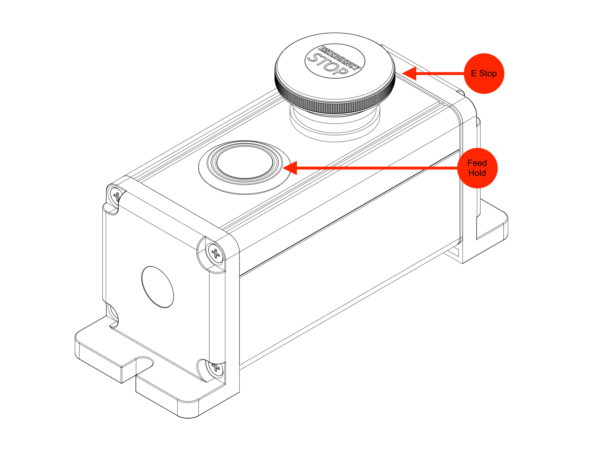

  • 1x Power Pendant
  • 1x Power Pendant Cable

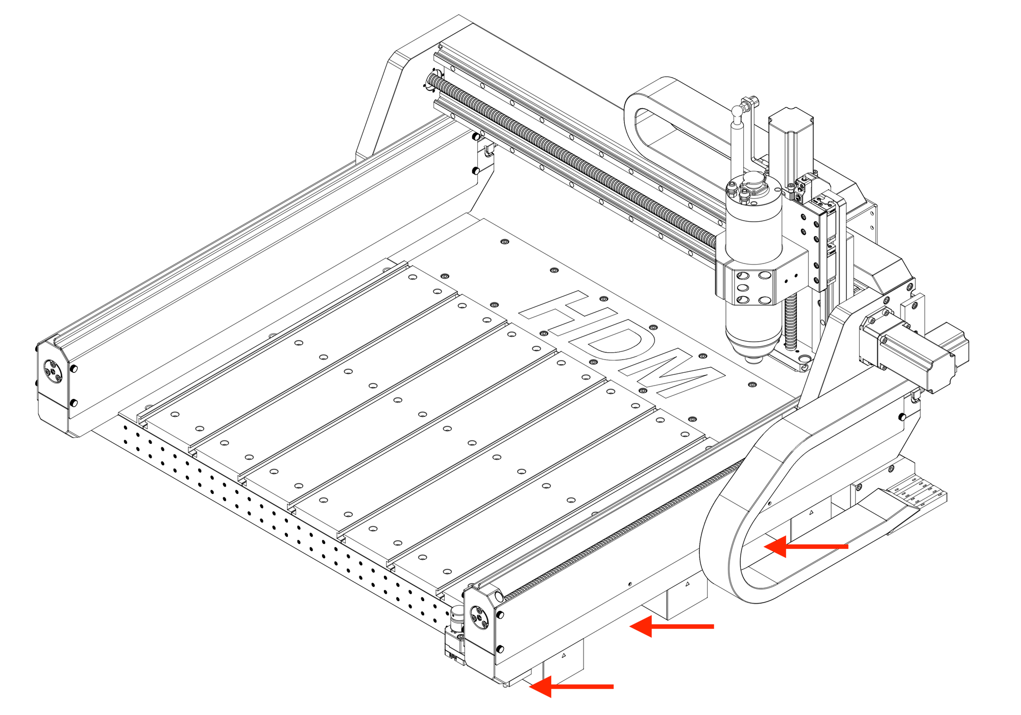

Unpack & Move the Machine
  • Open the crate from the top and remove the top and all side panels, giving clear access from all sides.
  • Remove the accessory boxes from the crate and put them to one side.
  • Lift from below the Y rails between the base frame members
    • Never lift the machine from the ball screws, motors, or drag chains.
    • Keep the machine level when lifting.
  • Set the machine on a clean, sturdy, level work surface, supporting all base frame members.
    • It's recommended that you use a forklift, or hoist where available but can be moved by 2-3 able people.
  • Please note that cables come from the machine, and the Y drag chain is unsupported. These should remain secured before lifting—ensure they do not get caught or trapped under the machine when placing them down.
    • When placed on a workbench - these should be supported.
Lifting Points
Lifting Points - Mirrored on both sides
The Controller
The electronics cabinet contains the Warthog controller, power supply, and variable-frequency drive (VFD), which controls the water-cooled spindle. The Warthog controller uses a 36-volt power supply to power the motors. Warthog combines optical isolation and a USB connection to the computer for increased immunity from electrical noise and static discharge.
  • Always turn off the power switch on the electronics cabinet after using the machine.
  • Before opening the electronics cabinet, turn off the power switch AND unplug the power cable from the outlet.
  • Connectivity should only be done through USB.
Controller Setup
  • The controller can be wall-mounted using the key slots on the rear. These are spaced at 215mm.
    • The controller should be placed within 1m of the machine.
  • Alternatively, the controller can be placed on a flat surface.
    • Ensure the two air vents on the left side of the electronics cabinet are not obstructed to permit free airflow.
    • The controller's location should be sheltered from dust and moisture.
Plug in the cables
  • Refer to the HDM 3.0 Electronics Diagram
  • Plug in HDM-W1 into the controller.
  • Plug in HDM-W2 into the controller.
  • Plug the spindle cable into the controller on the right side.
  • Connect the power pendant to the controller using the provided 6-pin cable.
  • Insert the power cable into the jack on the side of the electronics cabinet.
  • Plug in the USB cable and connect it to the computer.

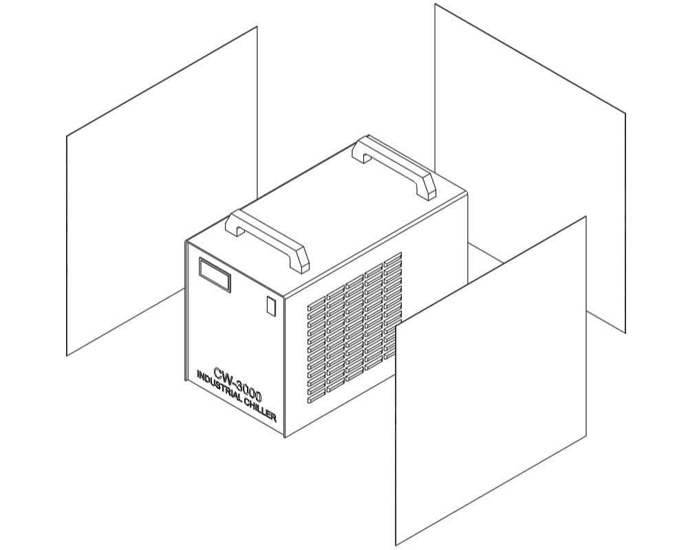

The Chiller (CW3000)
The CW3000 chiller is a non-refrigerated industrial chiller. It continually circulates coolant through the spindle to prevent overheating and maintain consistent, high-quality cutting. In the event of a malfunction, the chiller displays an error code on the LED screen.
The chiller has a built-in coolant flow sensor built in, there is no need to install an independent one in-line with the spindle. If the flow of coolant is restricted, you will see an error code.
Setting Up the Chiller
  • Place the chiller at the base of the workbench or on the floor beneath it.
    • The CW3000 is a recirculating chiller. It's function is to reduce the coolant temperature to ambient levels.
    • It should be placed away from dust and debris.
    • Approximately 30cm (1 foot) of clearance should be maintained around the unit for best performance.
CW3000
CW3000 Chiller
  • Locate the two 8mm coolant tubes exiting the Y-Axis drag chain (at the back-right corner).
  • Push the two 8mm tubes into the two 8mm push-fittings on the rear of the chiller. The tubes are interchangeable.
  • Gently pull on the tubes to check the secure connection.
  • Plug the power cord into the jack on the back of the chiller and a power outlet.
  • To fill, remove the cap on the top of the CW3000.
  • This unit can accept 9L of coolant.
  • Fill the CW3000 with either:
    • Fresh distilled water and general-purpose automotive mono-ethylene glycol-based coolant.
    • Wiper fluid can also be used but should be diluted to spec.
    • Note: Coolant must be diluted according to the manufacturer's specifications. Failure to dilute the coolant with distilled water will lead to a low flow alarm on the CW3000.
  • Replace the reservoir cap.
  • Run the CW3000 for several minutes to purge air from the system and check for any leaks at the connections between the machine, hoses, and spindle.
Notes
  • The chiller MUST be turned on when operating the spindle. Operating the spindle without the chiller could cause fire and/or catastrophic damage to the spindle, VFD, or machine.
  • Always leave the chiller on for an additional 5–10 minutes after turning off the spindle/VFD to allow the spindle to cool completely.
  • Never run the chiller when the coolant tank is empty.
  • Ensure plenty of clear space on all sides of the chiller to allow for adequate air circulation.
  • Always use distilled water, windshield wiper fluid, or antifreeze in the chiller. Using non-distilled water will lead to bacterial growth inside the tank.
  • Antifreeze is recommended when operating in a cold environment.

Machine-Control Buttons
The HDM 3.0 doesn't have any physical buttons. Control for the machine is done via the computer and the Power Pendant and Controller.
  • e-Stop - Press to e-Stop. This will cut the power of the machine. Twist to turn the power back on.
    • This should not be treated as a power button.
  • Feed Hold - Press and hold the button for feed hold. To continue, press Resume in Carbide Motion.
