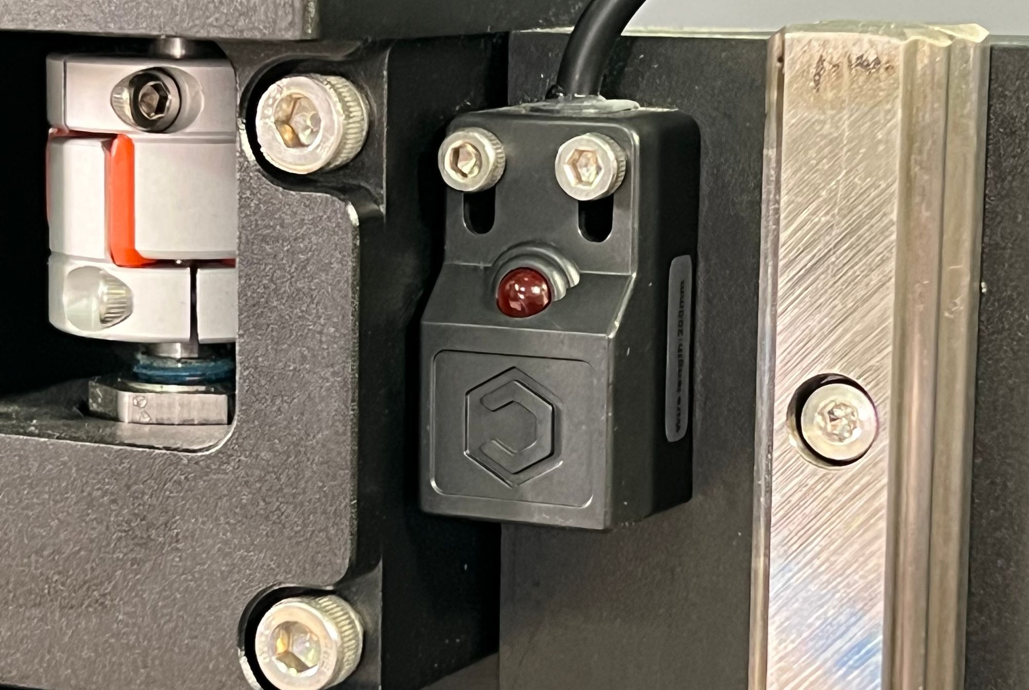

Testing Homing Switches
Each inductive switch has a small LED light that lights up when it senses metal, making it easy to test the switch.
- Power on the machine.
- Ensure the machine axis is more than an inch away from the switch.
- Ensure the LED is off. If it's not, you likely have a broken switch.
- Put a piece of metal in front of the switch. Ensure the LED is on. If not, you have a bad switch or a broken wiring harness.
