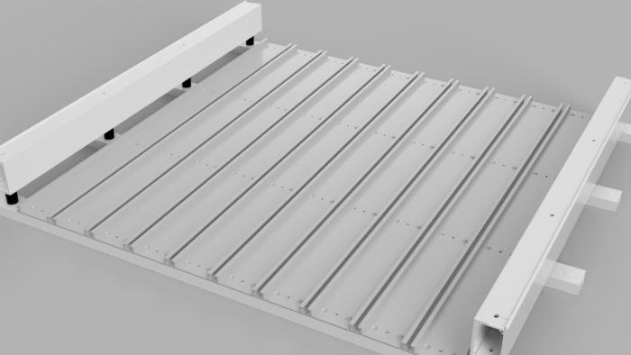

The final part of the Hybrid Table are the front-to-back T-track extrusions that bolt onto the Nomad tubes.
Hybrid Table with T-track
The T-track extrusions add to overall rigidity of the Hybrid Table. When bolted to the Nomad tubes, the T-track extrusions keep the overall frame from shifting or “parallel-o-gramming”. (Yep, that’s now a word)
At each point that a T-track extrusion crosses a Nomad tube, there are two M6 screws connecting them.
It’s worth noting a few things about the T-track extrusion:
That’s a lot of screws that have to line up for the Hybrid Table to come together and it only works because each extrusion is machined in-house on an industrial machining center (typically a Haas VF4). No hand-drilling, no drill presses, no machining on a homemade machine.
Complete Hybrid Table

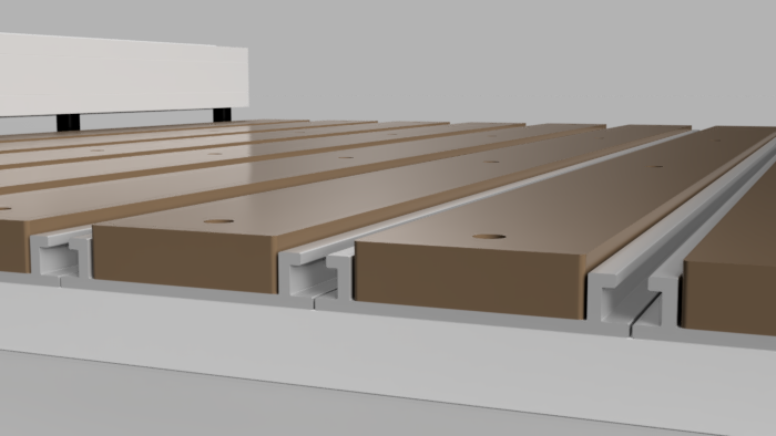

If you asked us to list the top things that trip up people who are new to CNC, work holding would absolutely make it in the top three. We’ve put a lot of effort into our workholding collection to try and help simplify work holding in general but you also need something to bolt those accessories onto. The Hybrid Table t-slots end up being a great place to start.
The area between t-slots is filled with MDF slats, which is what your project would generally rest on. We use 3/4” MDF so it will stand proud of the t-slots by approximately 3mm. That gives you plenty of margin to take a skim cut across the table to make it totally flat and still have a little extra to cut into the MDF without hitting any aluminum.
Nomad tubes in Hybrid Table
That skim pass is optional, and won’t matter at all for most users but we want to make sure it’s an option for those who need it.
The MDF slats are easy to make on a table saw when you need to replace them.
