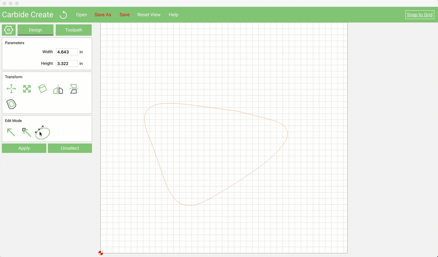

(NEW) Curves now support smooth/sharp nodes
Edit node smoothness
In past releases of Carbide Create, we've only supported smooth curves which made some shapes very difficult to draw so we added support for sharp nodes.
To change the behavior of a node:
Smooth nodes will be shown in blue, sharp nodes will be shown in black

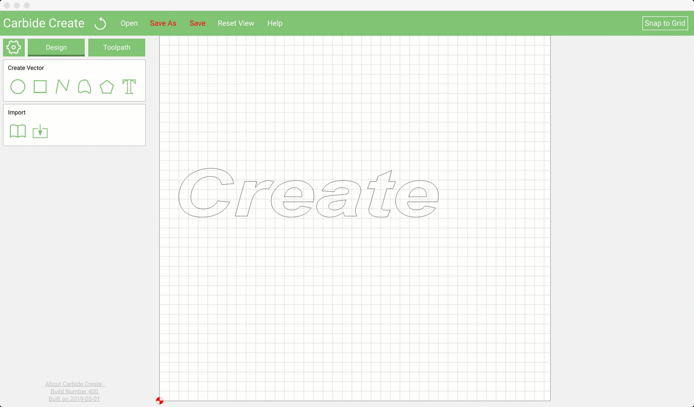

(NEW) Transform commands now support draggable box
Users have been asking for a better way to manipulate objects without having to type numbers as much. They were right, we were thinking too much like a group of engineers when we wrote Carbide Create so we've fixed it now.
There are three "Transform" commands, Move, Scale, and Rotate
When you click on any of these commands, the transform box will appear around the selection to directly manipulate the selection.

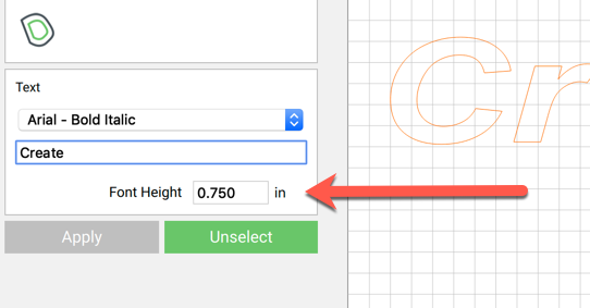

(NEW) Text now has a "Font Height" parameter
Set the font height
The old text command let you set a a target height/width and then Create would scale the text to best fit that bounding box. This was confusing for new users and it made it impossible to make two different lines of text look the same height unless the text was identical. For instance, a line with "ee" would naturally be a different height than "EE" but the old Create didn't consider that.
We've added a new "Font Height" setting that sets the starting height of the text you've entered. Note that we consider this to be a "reference height" and you may have to scale after to get the exact height you want. Without going deep into font theory for why this is the case, we'll just say that not all fonts accurately report their height.

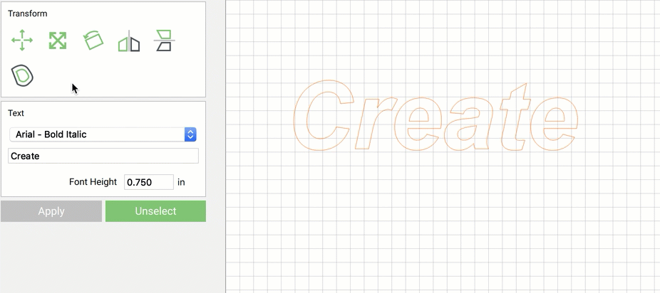

(NEW) Text can be scaled in only one direction
Text stretching
Using the scale command on text now allows you to stretch text in the horizontal or vertical direction without needing to maintain the aspect ratio.
This transformation, and all text transformations, are kept in the text object itself so you can change the words and the text should update in place with the existing transformations in place.

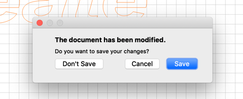

(NEW) Unsaved file warning when exiting
Unsaved work
When you try to exit the program with an unsaved file, Carbide Create will now warn you to save first.

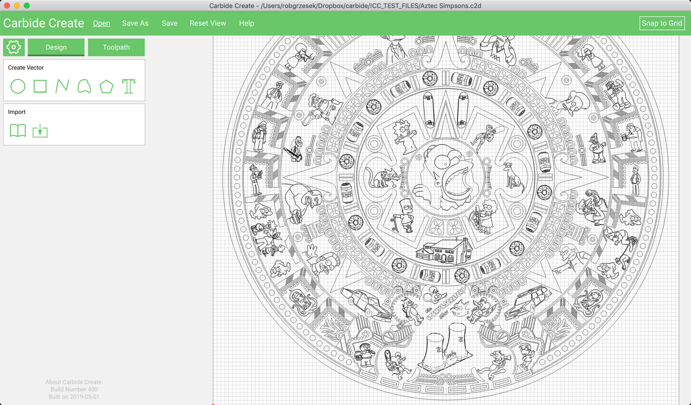

(NEW) Optimizations for large file loading and selecting
Aztec calander image
Those "Aztec Calander" files has been really tough for Carbide Create to deal with. In 400, we've spent some time to optimize a lot of code to better deal with files that have thousands of vectors. It's not perfect yet but it's much better than before.
