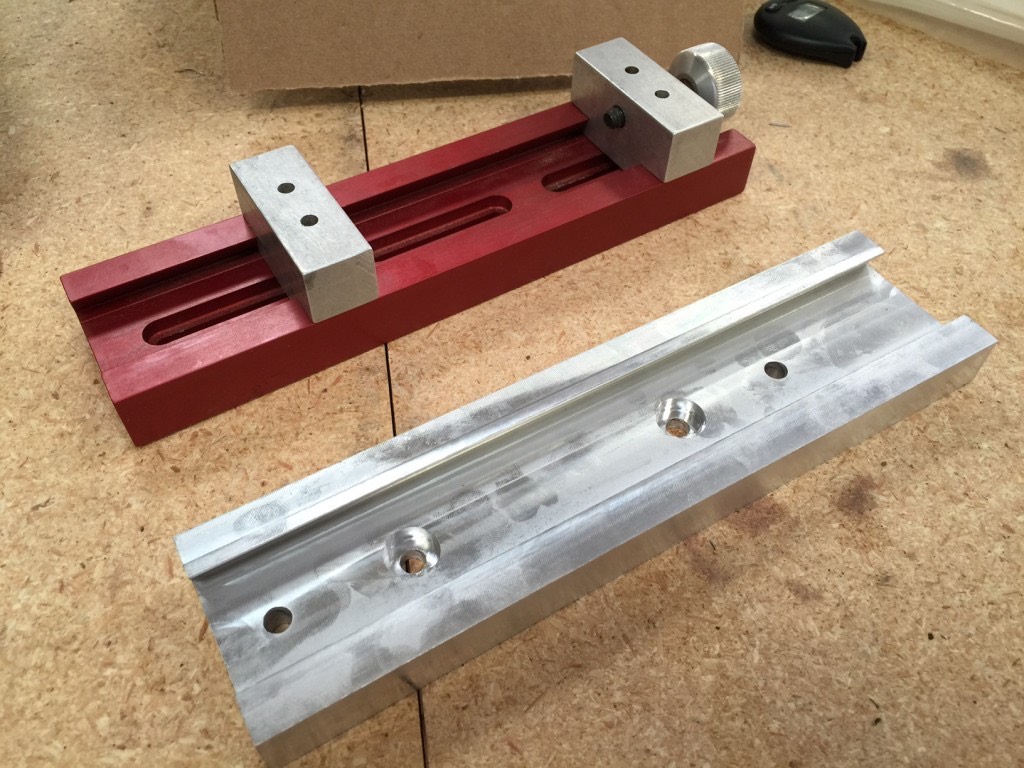

For those who have been following our progress over the past few months, it’s clear that we’ve been limited by the machine shops we rely on. We should probably just declare now that we’re control freaks- rather than find addition vendors, we decided to buy a machining center to make it possible to do more in-house.
This turned out to be more complicated than we initially thought so we decided to document it here to help others.
The first question was, “Do we buy new or used?” For us, this was simple, buy it new. While we’re not new to CNC, we were new to industrial CNC machines. We didn’t know how to identify a good or bad used machine, we didn’t know who to call to move it, we didn’t know how to get it up and running. We could have figured it out, but, as they say, time is money.
The other thing we saw from our current machine shop is that parts on their older machines were always breaking. We’d go to pickup our parts and go home empty handed because a pump or encoder went bad on the machine we were depending on. We didn’t want to spend time trying to learn how to run a big machine while potentially dealing with problems.

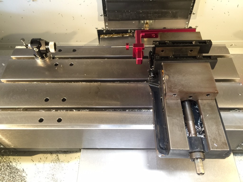

We also got the Renishaw probing option and it’s awesome. What we did’t realize is that the tool length probe is mounted on the table so it’ll eat into your working area. You can remove it but then you can’t use it and you have to recalibrate it when you put it back on the table.
Just to be clear, the Haas reps never hid this fact from us, it was right in front of us in every photo we looked at. It just didn’t click for us until we were looking at the machine in our shop. If you need the whole table and the probe, look at the next bigger machine.

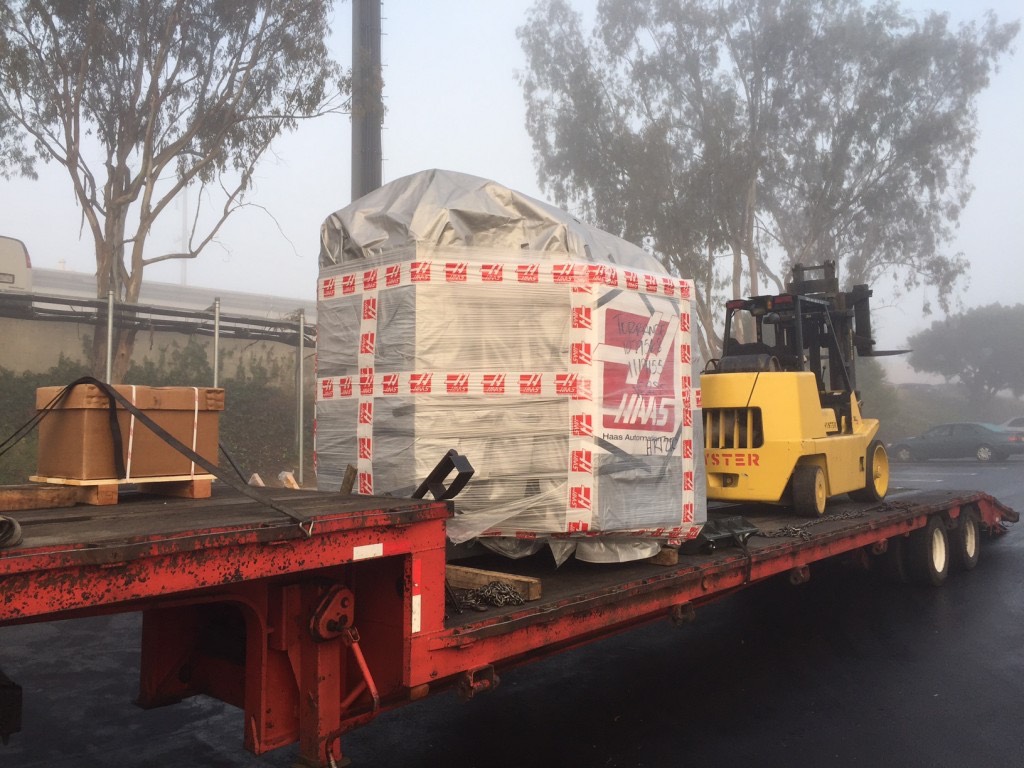

Our machine had a three week lead time once we got the financing signed. We were told that the next size machine up (the VF-3) has a two week production time, so it’s possible to get a machine quickly if you need it.
We were given an expected date from our rep right after the order went in and they met that schedule to the day.
We’re only an hour from the Haas factory so our machine was complete on Friday, and delivered on Tuesday.
The VF-2 is an 8,000 pound machine, and this seemed like a big deal to us. You know how long it takes a rigger to move an 8000 pound machine from the truck into the shop and place it? 30 minutes. It turns out that a four ton machine is nothing for people who move machines for a living.
