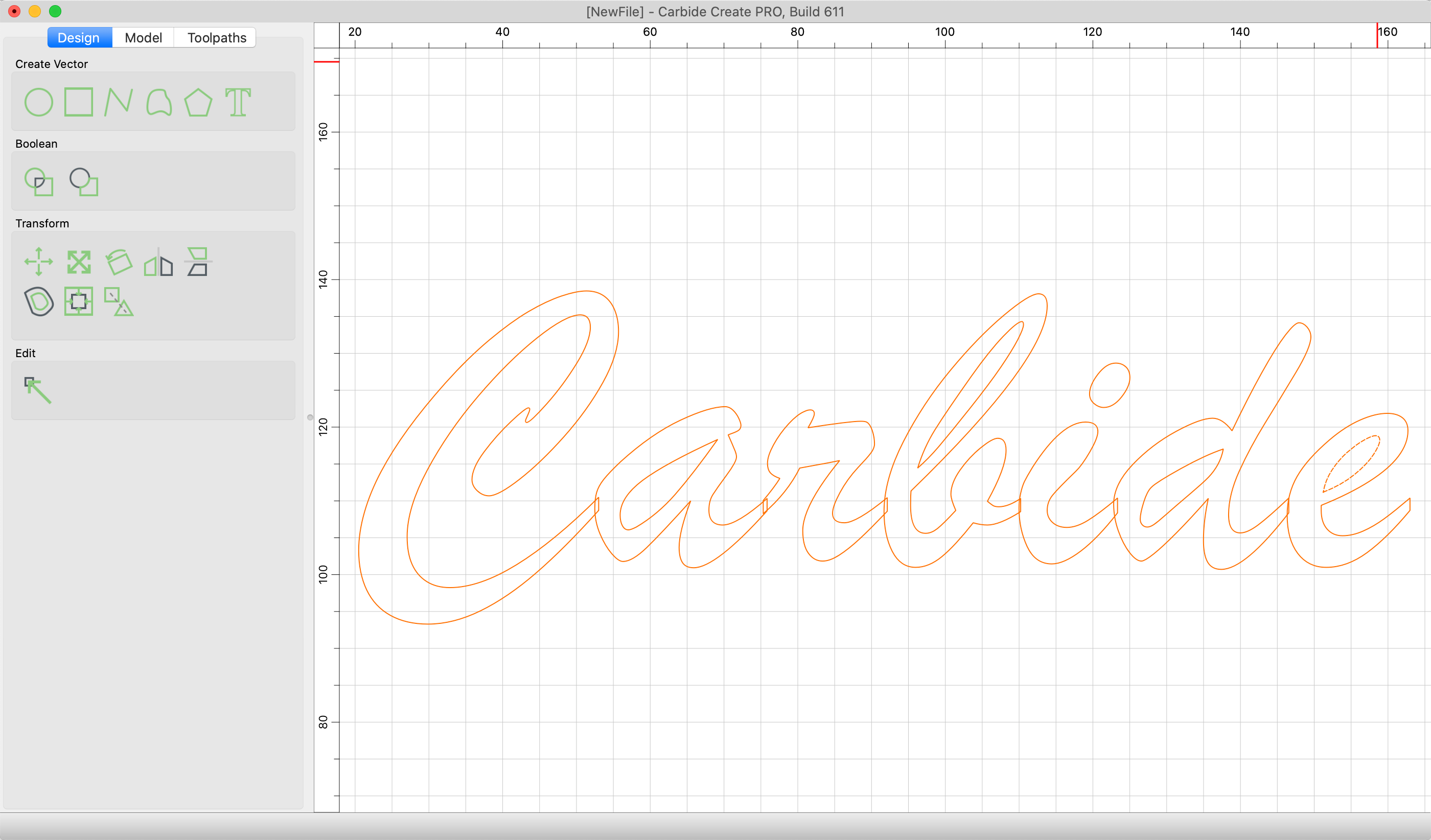

Text after boolean
Now that you have a series of curves, click the Boolean Union command to merge overlapping curves into combined objects.
Admire your work
You'll now have merged text curves that you can machine with a V-carve toolpath or cutout completely with a contour toolpath.
