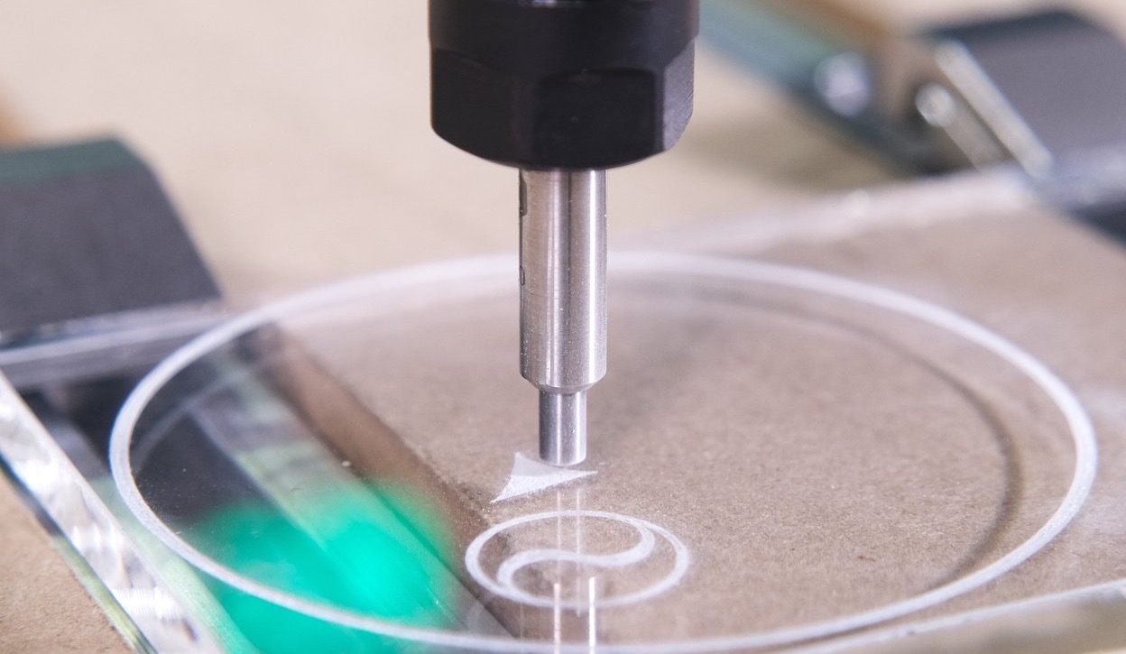

Drag engraving
Diamond drag bit for engraving Diamond drag bit engraving acrylic
The last type of CNC engraving is with a diamond drag bit. The name says it all, it's a sharp, spring-loaded diamond tip that's dragged along the material to be engraved. The bit does not rotate at all, it's just dragged along the surface. Suitable materials include:
Because the diamond drag bit is pressed against the material, there's not a lot of cutting depth and not a lot of control over what little depth there is. Drag engraving is capable of generating spectacular results in materials that typically cannot be engraved on a CNC milling machine.
We make our own bit for small CNC machines, the McEtcher Diamond Drag Bit.
Diamond drag bits do not require any special toolpaths. You can use the same 2D contour toolpaths that are used for traditional engraving cutters, with the exception that the spindle should not be turned on.
Drag engraving is the easiest engraving option available. You don't need a high-speed spindle and the spring-loaded tip makes the process very forgiving of uneven material or questionable workholding.
