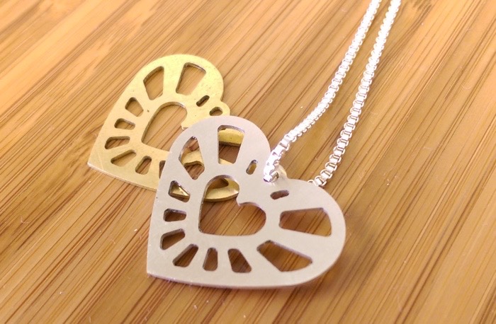

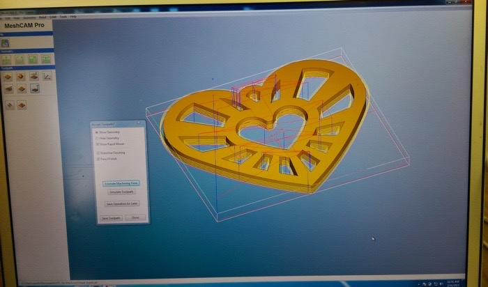

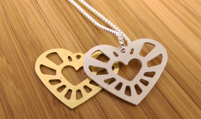

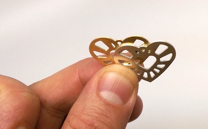

Apollo did this as a quick test for a jeweler that was interested in a Nomad 883. Thin metal can sometimes be difficult to hold down for machining- it’s easy to bend the parts when trying to remove them, or they can break free if they are not big enough to hold down with double-side tape.
For this project, Apollo used our fixture wax to securely hold the wax during machining without fear of the parts breaking free. Our fixture wax can be found here.
