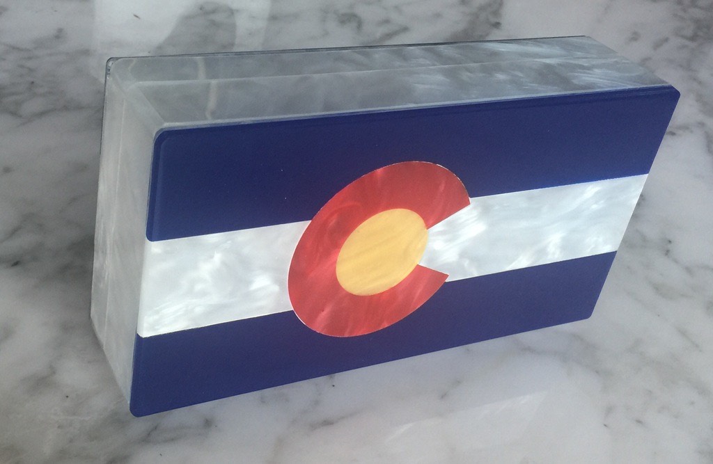

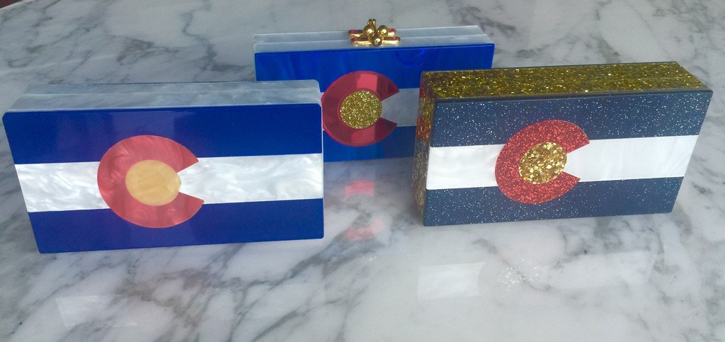

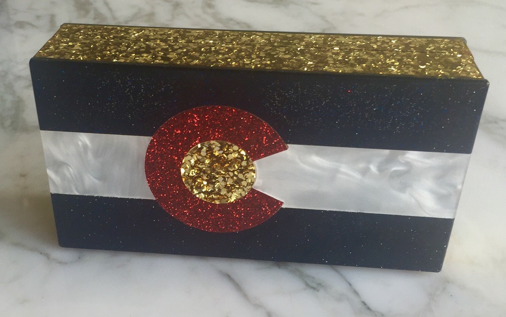

“This project is for the girls ;)
The design: Colorado state flag.

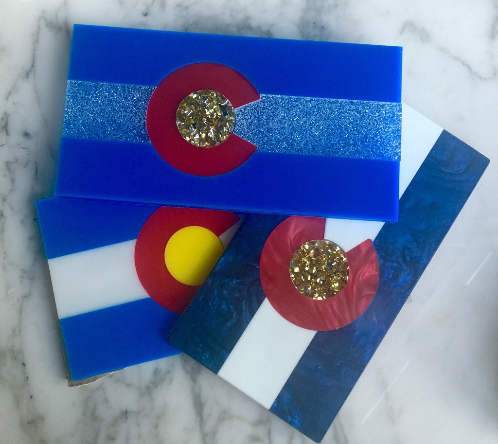

Used Carbide Create for the shapes, acrylic cement to piece together.

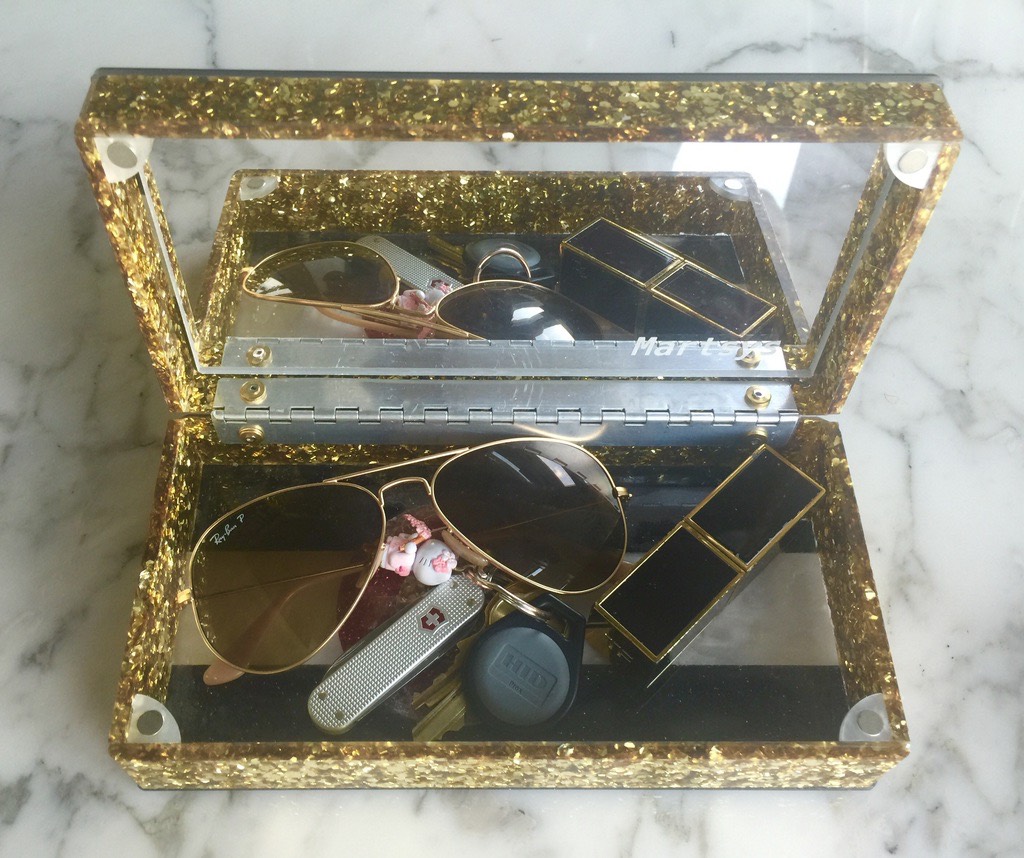

MeshCAM and Fusion to design and cut the chamfered edges on the bottom for hinge, opens and stops to 90 degree angle. Rivets to attach hinge and magnets or clasp for closure. Mirror inside engraved in Carbide Create.
Not quite perfect yet - but I’m enjoying the journey!”
