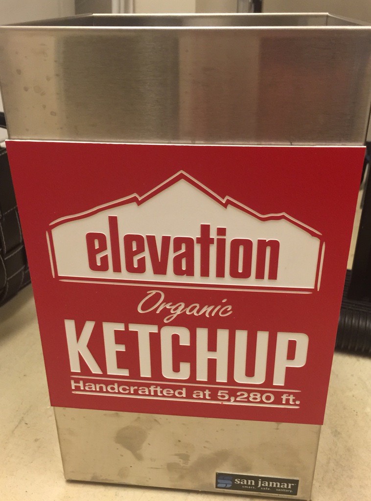

Martha made this sign for her friends growing ketchup business, https://www.elevationgourmet.com/

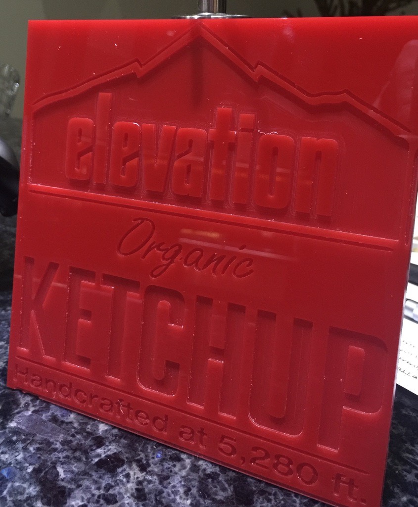

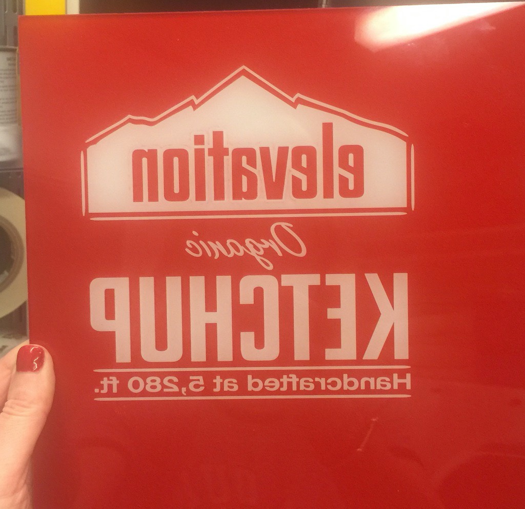

Material: 2 tone acrylic
Process: Load DXF file in Carbide Create and use the pocket feature
Total cutting time was about an hour with a .003” depth per pass
Magnets were used to attach the sign to the metal canister.
