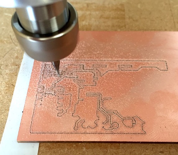

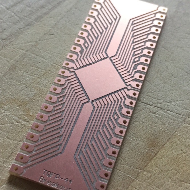

Marc was one of the first users to get his Nomad 883. He used the pcb2gcode plugin for the Eagle to generate gcode to mill circuit boards directly from within Eagle.

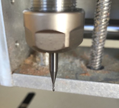

When he got in touch with us, we recommended that he use the T1 mills from T-Tech. These are V-shaped cutters that are much more durable than the fine endmills that others recommend. The other benefit with a V cutter is that you can control the cutting width by changing the cutting depth.
