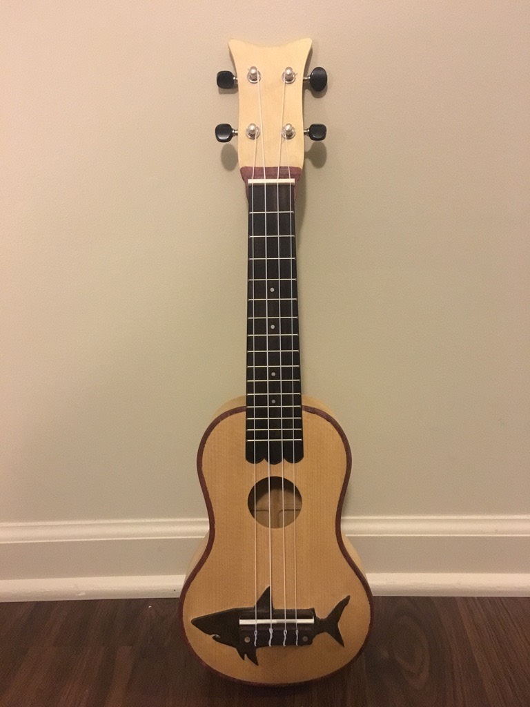

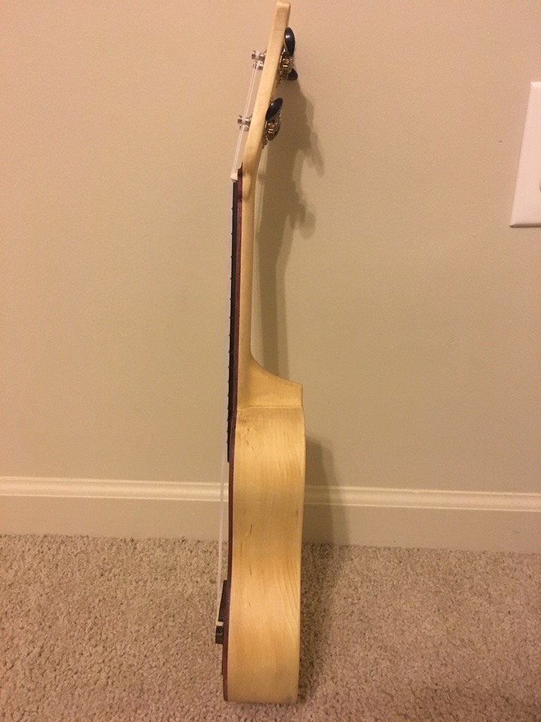

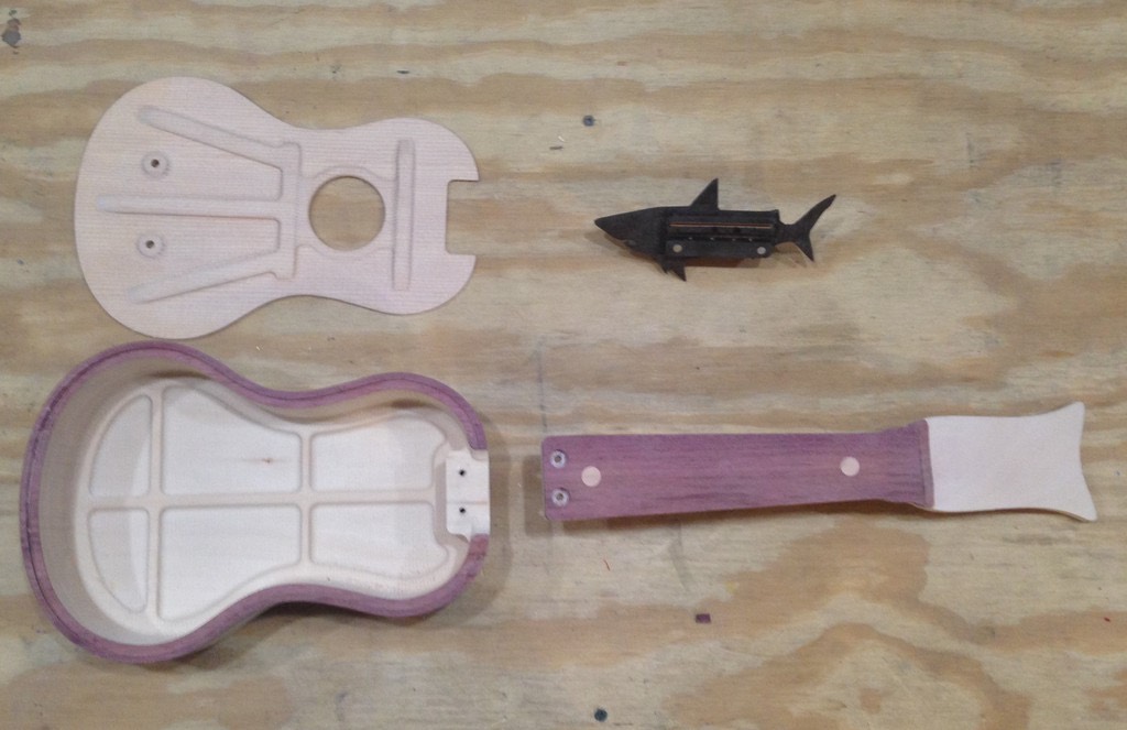

This is a soprano ukulele that I made almost completely on the Shapeoko.
The main body, neck, bridge and soundboard were machined by me while the rest of the parts were purchased. Both the neck and body are basswood with a thin layer of purple heart used as trim. The body was milled from a solid block. The soundboard is spruce wood and the bridge is cherry wood with a dark stain.
