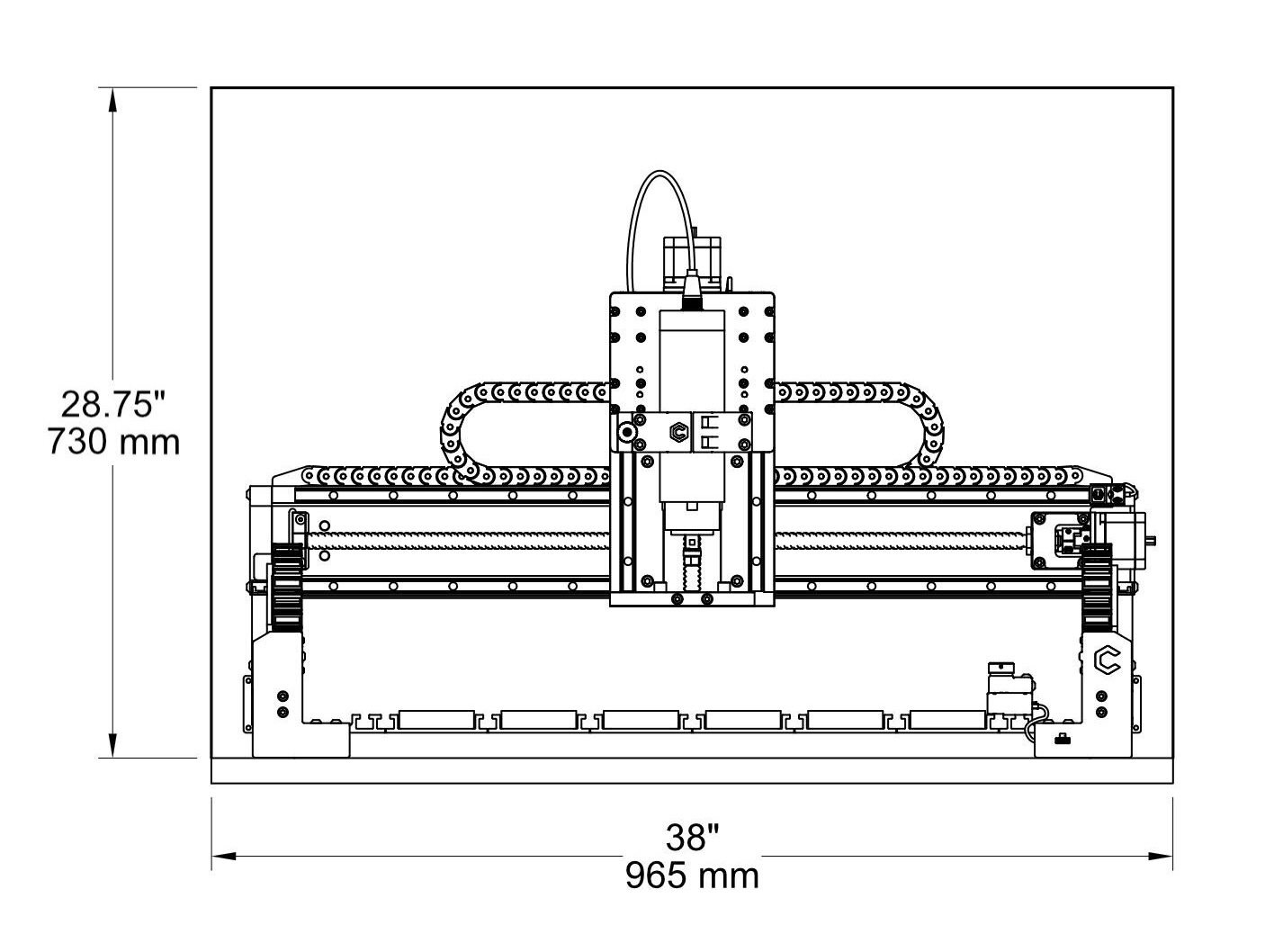

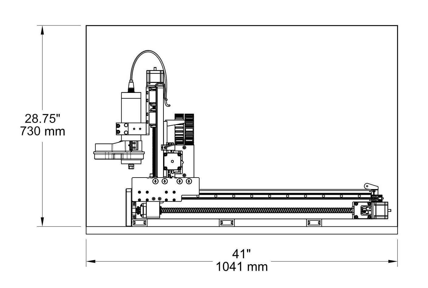

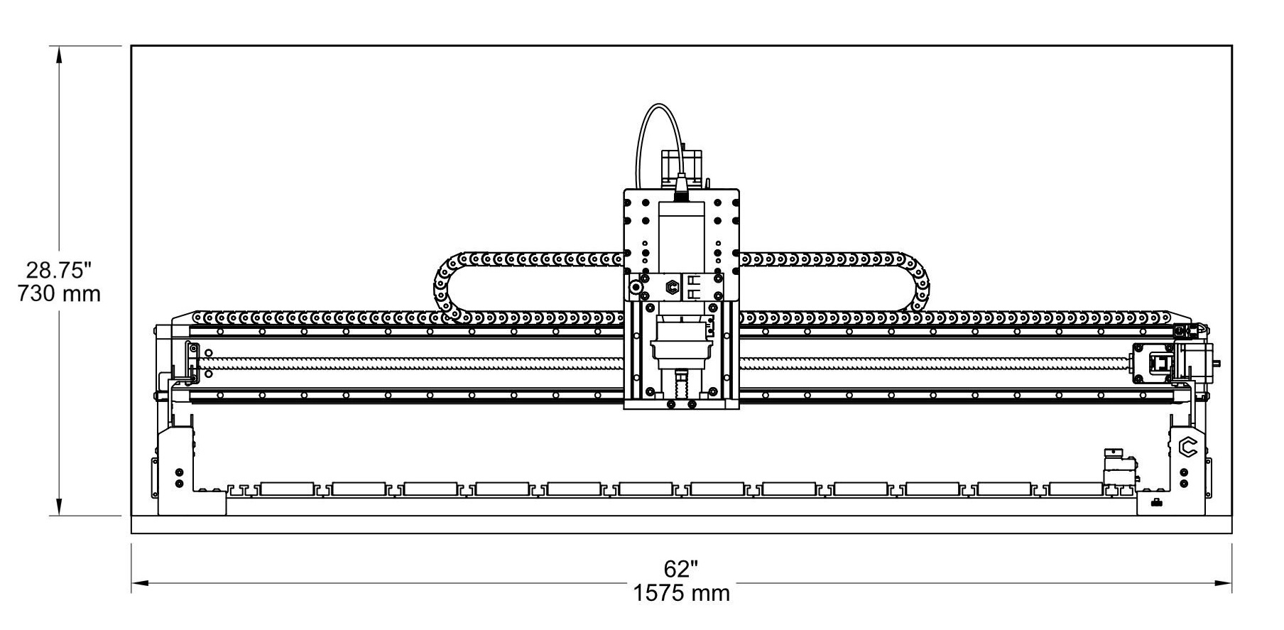

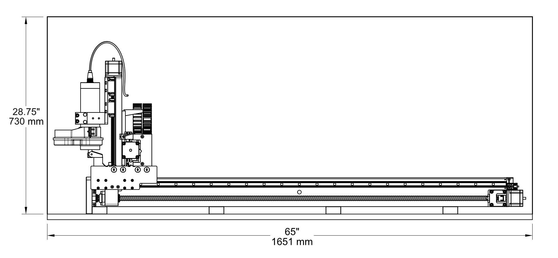

The Shapeoko 5 Pro needs to be placed on a table that is strong enough to support the machine and the materials being cut. The table should be big enough to fit the machine, but the exact size beyond that is up to you. The images below provide some context to the dimensions listed above to help you decide how big the table should be for your needs.
Click on any photos below to see a larger version.
